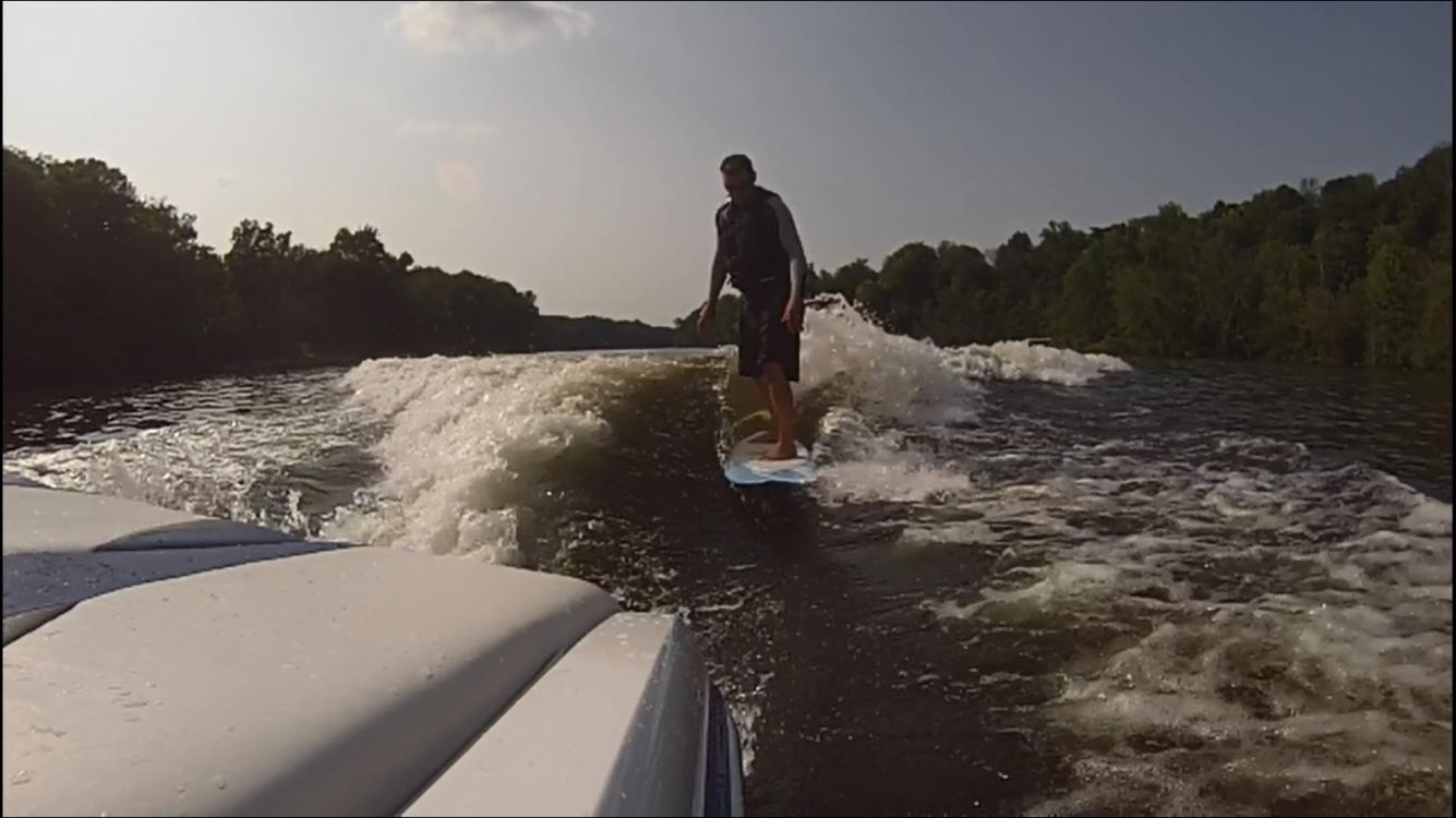

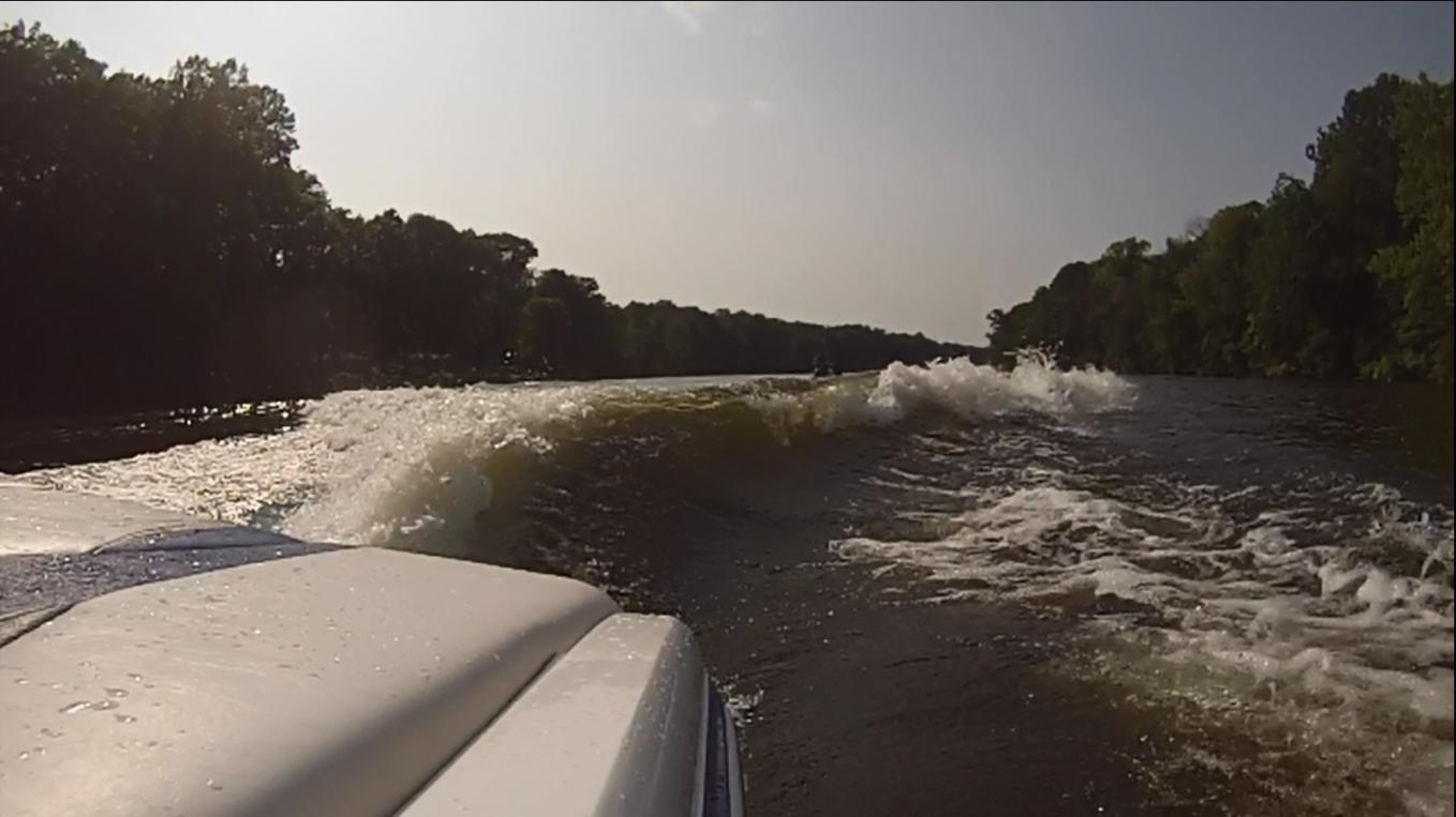

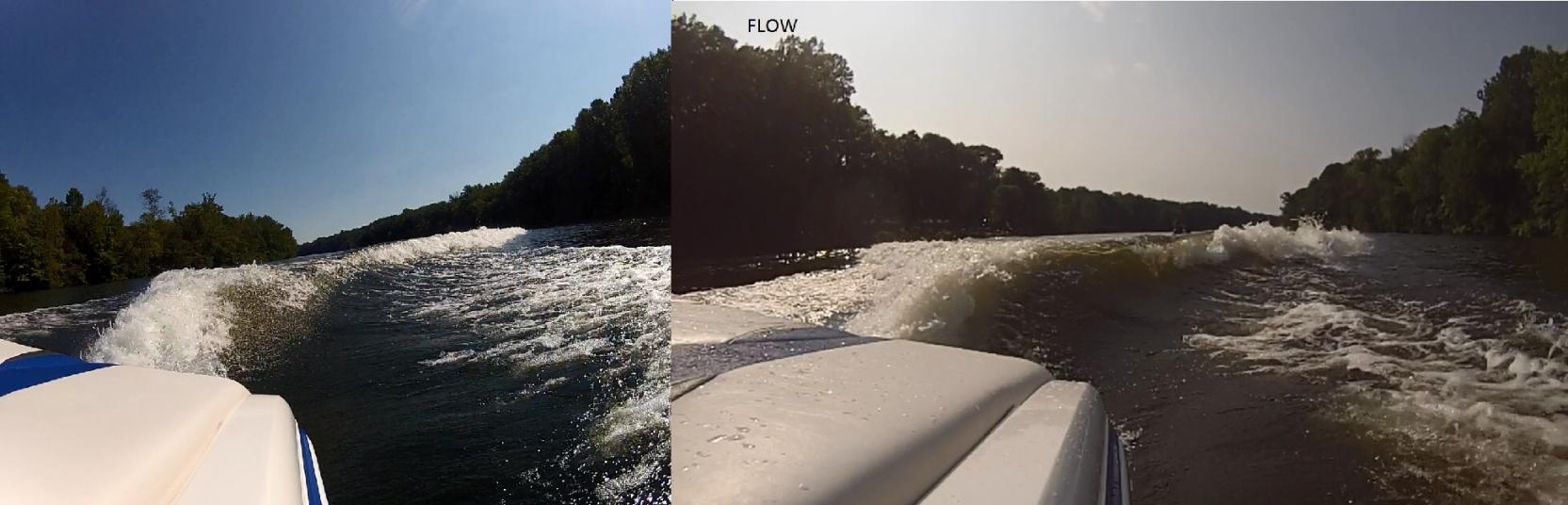

Hi all. I had flow installed on my 2012 LSV. Here are my findings after 2 weeks of surfing and experimenting. All of this is for goofy side surfing but expect it to be no different for regular side.
I have found the best position for the plate is rotated down so it hits bottom pin but not locked in place into one of the three position holes. I've tried this with various ballast configs and always this is the best position.
Even with no ballast at all this gets an ok surf wave. My son rides it no prob. But it gets better.
Best combo is plate in that position and front ballast 80-100% full. I put my passenger in the bow - right side. With just driver and Passenger in bow - need no more than no more than 300-500 lbs on right side and 150-200 on left side. This combo gives us a big clean rolling wave with the wake plate in the bow up position. Moving the wakeplate to the bow down position lengthens out the pocket nicely.
I found that too much ballast makes the wave less clean.
The above combo works outstanding. Love it.
