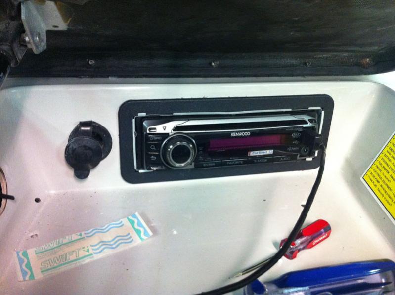

Headunit in its new location, where it would have been from the factory had I ordered it with a radio:
https://forum.moomba.com/attachment....0&d=1331906134
I need to get a trim ring for the faceplate, somehow I managed to lose the original.

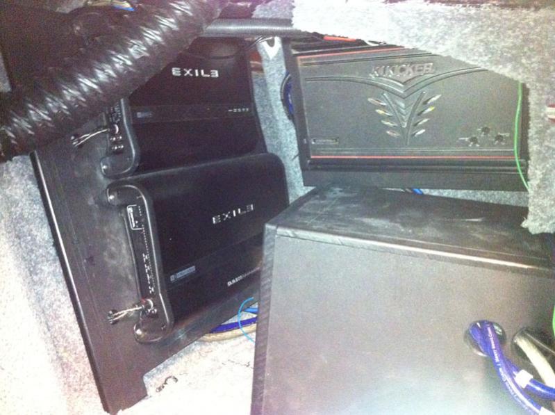

Amps mounted and the batteries in place. This picture makes it evident that I need to tilt the mounting board for the Kicker amp - weird, I couldn't see it in person, but it makes me mental in the picture, lol:
https://forum.moomba.com/attachment....1&d=1331906135

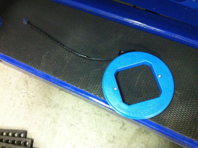

The first time I ran the speaker wires through my tower it was an absolute nightmare - like a few hours per side trying to fish wire through a tiny hole and get it to come out the other end.
The other day at Home Depot I ran across this little gem, intended to aide in the fishing of wires through walls. For $14 it is a must have for anyone considering a tower speaker install. I was able to fish the wire on one side in about 10 minutes, including time to drill!
https://forum.moomba.com/attachment....9&d=1331906132

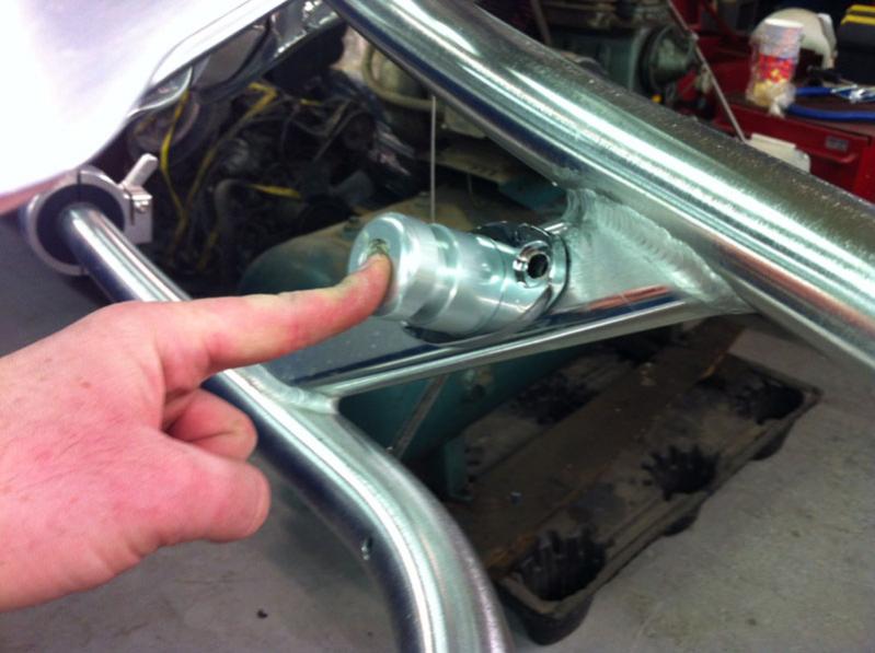

This is how I will mount the quick-release brackets - same location as my previous speaker install, even used one of the same holes. I need to get longer bolts to mount the bracket, hence the finger holding it in place for the picture, haha.
https://forum.moomba.com/attachment....3&d=1331906140
To get the wires from the oval bar into the front downtube I had to drill a hole through the downtube and into the oval tube - to cover that hole I will use a stainless steel plug, should make it blend right in.

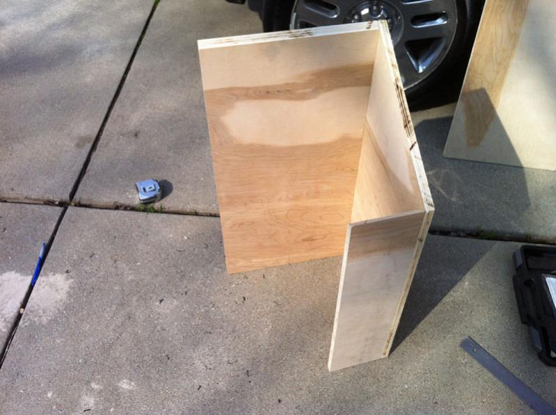

I spent some time working on the sub enclosure this weekend - a little more time that I expected actually, lol. I decided to go with Birch wood for the box, instead of a synthetic material. The reason being that I was completely winging the measurements with the compound curves, and at $18/ft using Starboard or similar would yeild some expensive mistakes.
What I've come up with is about 2.4 cubic feet, that will have an external port tuned to ~35 hz, and house 2x 10" Kicker L7s. I decided to go this route at the suggestion of Phil from Kicker.
My work area - it was so nice out I decided to drag my tools outside and work in the driveway, rather than my basement;
https://forum.moomba.com/attachment....7&d=1332168163
Piecing the box together - this is where I made a crutial mistake that I didn't realize until I tried to put the box into the boat - what is the mistake...

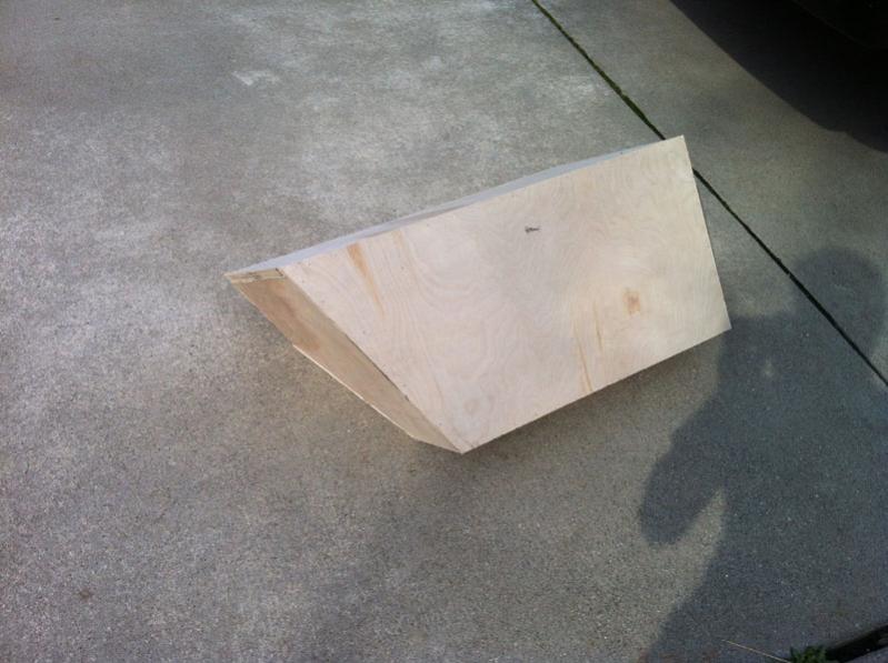

...the mistake was that I built the box backwards, LOL! Fortunately, I did not glue, and only used the pnumatic nail gun, and hadn't put in any batons yet - so all I had to do to correct was pry it apart, pull all of the nails, and re-build the correct way. I need to cut 2 new pieces based on the angles, but that won't be an issue at all;
https://forum.moomba.com/attachment....6&d=1332168162
Once I get the sides cut I'll get it in the boat for a test fit and mark where my port will go - I'm thinking that it will come out of the top left side, and vent forward, but I need to measure the clearance before I start cutting.
