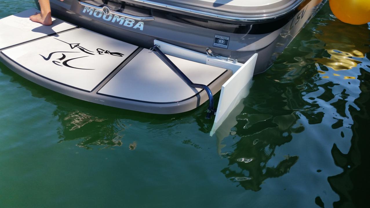

I liked your version a lot (version 2? in the pic below for you guys who haven't seen it-- tried out Daze's gate and really loved what it did for my wave). However, my cutting boards were only 20" long so I couldn't make that one. Had to modify the plans for the ones Joe and Russ made.

Something soft like splitting a soft hose down the middle or using Hydro Turf. If it is slammed against the hull like it will be maybe it will be all right?
I have tons of hydroturf lying around. Maybe I'll try something.
I used some left over hydro between the gate and the hull, it doesn't move or rattle much.
You're gonna love the results, I still only put %50? on the non-surf side, I've also found that I don't need my IBS.
Remember to only turn toward the gate side, use it as an advantage, you'll be able to spin the boat.. :)
I come off the throttle, sharp turn towards gate, causes me to 180 back towards the rider, then head at them, then sharp turn again before running them over causes another 180 and the backend swings around in front of the rider.. :)
I spent several days using Daze's gate above. Put it on my boat when we were on vacation and never gave it back till we loaded up to leave. ha ha.
I had never run anything in the opposite locker. Now I have a 540 opposite my 750. I plan to start with the 750 full, the center 400 and mini IBS (about 375) full and about 400 in the 540. I have a 400 under the surf side seats. I anticipate not needing it anymore but intend to try it both ways. The other thing I noticed using Daze's gate is I only needed about 1/3 of the wakeplate I would run without it (from almost all the way up to about 30% up). We'll check on that too.

I didn't with my gate, seems like a lot of extra work, doubtful it has much impact on the wave, it's such a small surface area(the curved extra part)..
I could be wrong however you can't reverse the gate and you loose some surface area, I think my gate is 12 x 24...
I don't use the plate that much anymore it's usually all the way up, just adjust the speed .2 one way or the other or add/remove out the non-surf side. The great thing at least with my gate the wave is always the same, there's really no fussing around anymore. Fill it up, 11mph and it's almost the same as the day before, really consistent even with rive speed changes, fuel weight, etc, etc...
how far down into the water (below the swim platform) does a gate need to be.
Made mine even with the bottom of the hull at the outer edge. Might not need to be that deep but have to figure that's where the wave starts forming.
Mines deeper, remember the more roll the less gate is in the water... :)

started working on one last night, one question; I have the bottom of the gate flush with the bottom of the boat but how high above the platform does it need to go? Just thinking if it is on the opposite side of surfing, then because the boat is listing some to the surf side the there wouldn't be a need for the gate to be too much higher than the swim platform?
I have mine at least a few inches over the height of the water when fully weighted so the water doesn't flow right over the top of the gate.
My gate is 14 tall and 24 long. Mounts on platform centered, so I can use it goofy and regular. Stock LSV platform, works well.
Okay, here is version 2. Not much different than version 1. No more tie down strap, more stable. I'm trying to keep it universal for both goofy and regular. It is 14 by 24, plywood wrapped in marine vinyl. Am thinking of adding something between the gate and hull to fill the void, but so far doesn't seem to be an issue. http://images.tapatalk-cdn.com/15/09...2e20525157.jpghttp://images.tapatalk-cdn.com/15/09...d99b0be24e.jpghttp://images.tapatalk-cdn.com/15/09...e103d8d0d6.jpghttp://images.tapatalk-cdn.com/15/09...6ccf0525b8.jpg

The pocket is much bigger, was able to tell an improvement in the push in comparison to not using the gate.

You notice any issues with the small gap between the hull and the gate?

I have a similar build and platform. But I have a LSV. The only thing I'm scared of is the water pressure pushing on that bottom lip of the platform. I have a feeling it will crack over time.
I don't have a photo of it'd mounted right now. But here's my version 1 prototype. Lol

mine is on a LSV, I agree there could be potential for cracking. From what I can tell the pressure pushes back onto the 2x4's that then is against the stern. you'll see two blocks pushing on the platform, those are not really needed, just added as a spacer for when everything tightens up.
