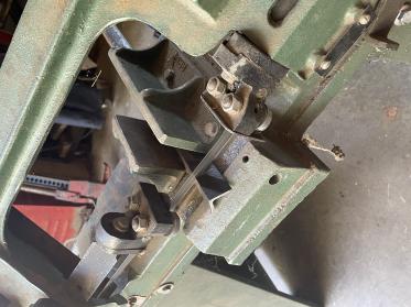

Prepping for new WM bags, and since my stock bags would pop out the engine dividers…
Attachment 30613
1x1 1/8 angle iron, cut to about 28” pretty close to the bottom channel and to not interfere with the upper locking nut and not scrape on the gel coat
Attachment 30614

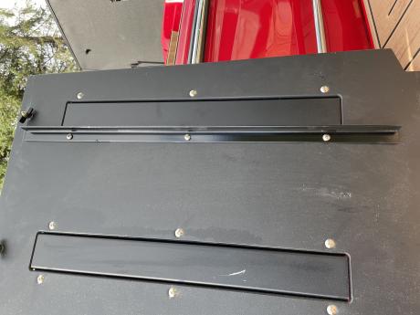

Using the existing hardware
Attachment 30615
Cleaned up and drilled, stock hardware is exactly 10” apart

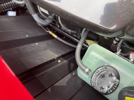

Attachment 30616
Filed down any sharp edges and painted

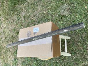

Attachment 30617
Installed just one per side to test…..

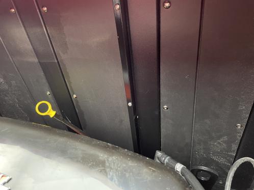

Attachment 30618
Attachment 30619
Have enough material to add a second per panel, plus some 1” 1/8 flat stock to utilize if required as well….
Was $24 bucks for enough material to make 6 angle iron brackets and 6 flat stock braces…. Surprised metal was still that cheap
I know everyone has done this a few times, and knows the issues…. I did notice on the front and back panels they had a small screw in the lower c channel holding them in place, but did not stop the front from popping out at the top after the middle had already pushed into the engine….
