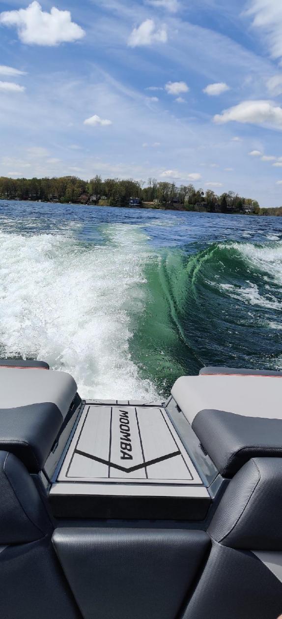

Just a pic from today of the wave on our Mondo for reference. 300 #s in the bow and 5 people in the boat.

Got setup just like that, 300 lb lead in the bow and just got some people to come. The key for us was to drop the speed to 9.9
Glad you worked it out. Our speed was 11.2. Just an observation, when we went to the shallow part if the lake (15-20ft), the wave was 1/2 the size.
That why they said to go slower. We took it to the dealer and he said we were going to fast and to try it slower and it worked so at least I can ride now we will bump it up and try different things from here.
