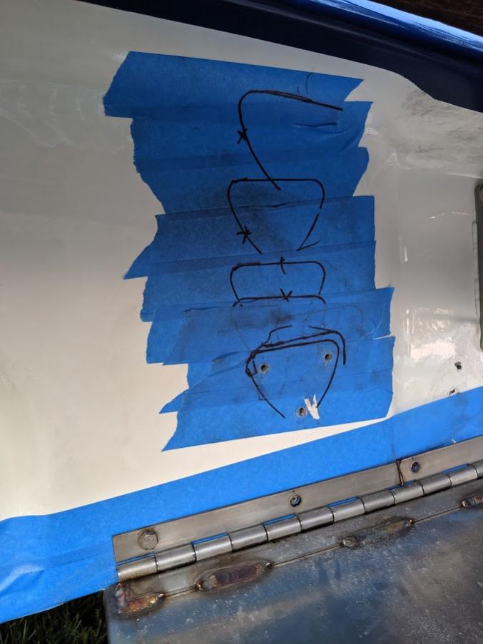

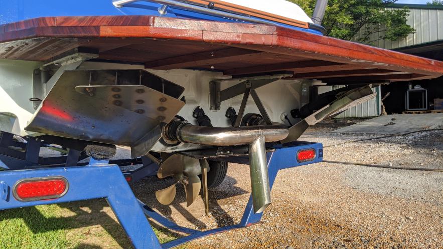

Show us what you did before?
Tige 23V.
It is a short lever arm, but no issue with the actuators.
30 degrees up 14 degrees down.
Attachment 28935
Lots of testing with placement to get it right.
Attachment 28936
