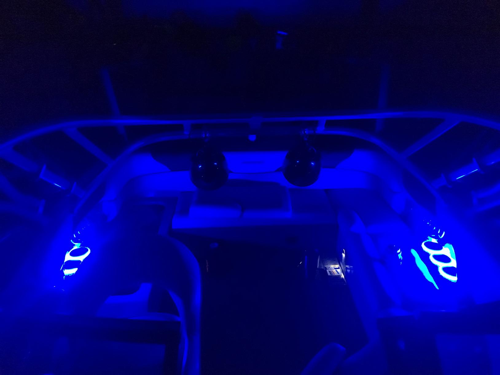

Kinda got the blue thing going on Attachment 26573
I bet... I had a hard time fitting my box between that seat base and the edge of the footwell. Glad you got it in.
I had to remove the seat and loosen up the steering column to get it in.
I only had to Remove the seat.
