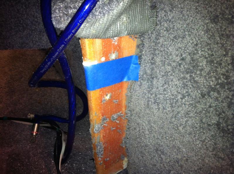

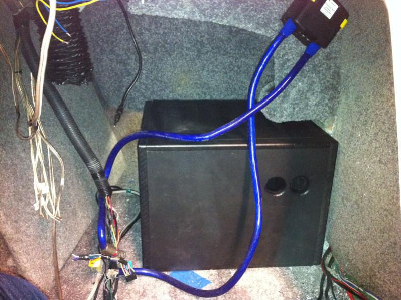

Slowly but surely, this project is taking shape. Last night I got the brace trimmed down to allow my battery box to fit, I cut out a hole in the glove box for my radio, and I also re-mounted the gunnel trim that I had re-covered (had a wakeboard fall out of the rack and tear the vinyl). I also decided to move my cabin speakers into the factory locations, which required the cutting of more holes. Needless to say, I am very itchy today.
I also got much of the wiring in the observers compartment tied and routed - all that is left is to mount the ACR, battery switch, and put in the amps.
The start of cutting that brace:
https://forum.moomba.com/attachment....5&d=1331303563
Cutting done and test fitting the box - I have since trimmed the carpet and stapled it to look nice and clean;
https://forum.moomba.com/attachment....2&d=1331303559

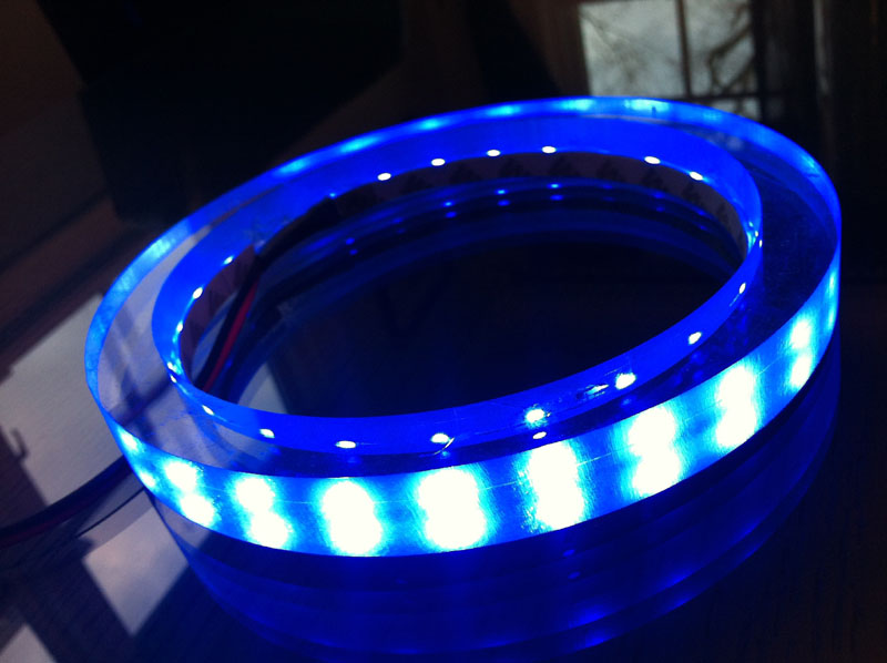

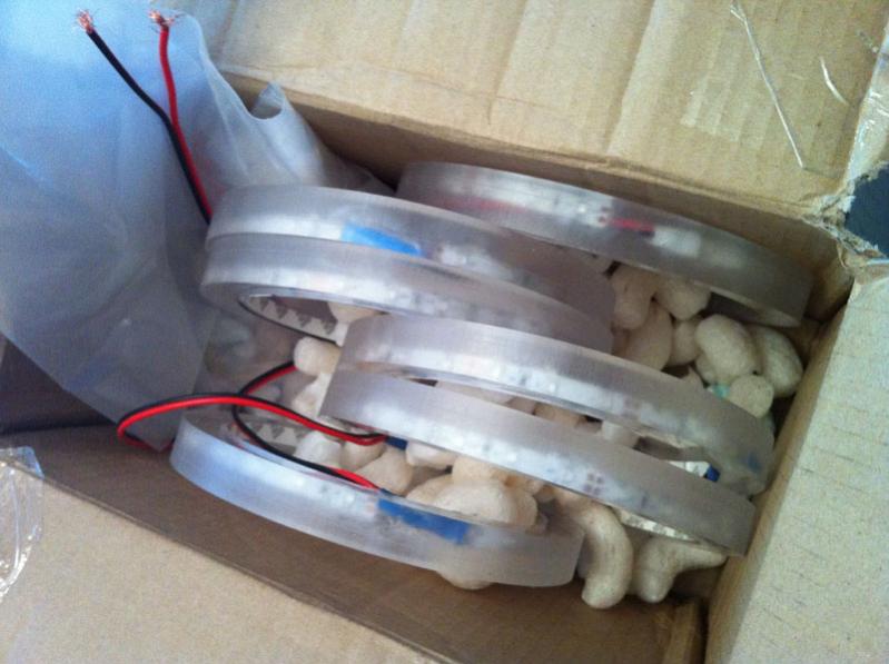

My wonderful wife purchased me 3 sets of blue LED Speaker Rings from a local guy we saw at the Detroit Boat Show - they look great, and were pretty cheap - $60/pair. Sadly, she is making me wait until my birthday to let me have 'em;
https://forum.moomba.com/attachment....3&d=1331303560
https://forum.moomba.com/attachment....4&d=1331303561

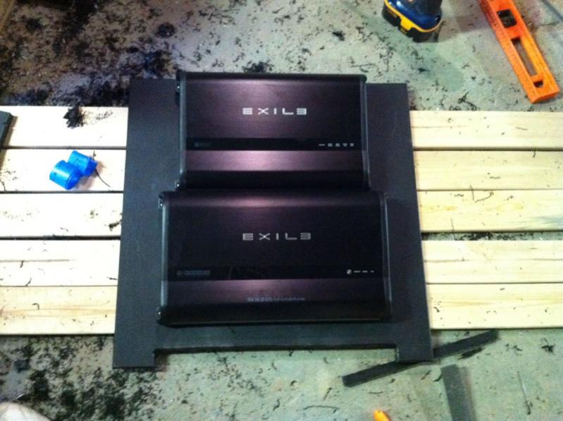

More progress, this time with the amp rack...
I cut the board to 24"x24" and decided to mount just the Exile amps on it - the Kicker will go on the backside of the bow seat, above the battery box. I cut out a channel to give the appearance of 'feet' on the board, and used a router to round all the edges;
https://forum.moomba.com/attachment....2&d=1331504501
https://forum.moomba.com/attachment....1&d=1331504499
Instead of mounting all 4 corners on 1" pedestals I decided to stagger them, with 1" rise at the top, and nothing at the bottom. I think it looks pretty cool;

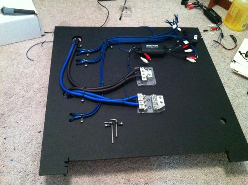

The backside of the board; I ditched the idea of displaying the distribution blocks - all that I have left is to run RCAs and the 1/0 from the distro to the batteries;
https://forum.moomba.com/attachment....4&d=1331504504

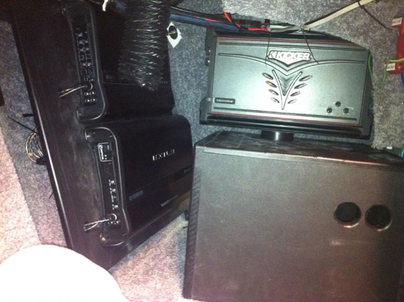

It is looking really sharp. Are you going to mount the amp board in front of the battery box?
This one will go on the outside wall, its the only place that fits everything and is out of the way.
I got the Exile amps in yesterday, wired and mounted the battery switch, connected the relays and switches for LEDs, ran the 8awg +/- for LEDs, and test fitted the Kicker ZX1000.1. I need to trim the Starboard to mount that amp on the backside of the seat, but this picture shows where it will be;
https://forum.moomba.com/attachment....0&d=1331645670
I also ran the wiring for the Kicker amp, so I just need to plug it in and I'll be good to go.
