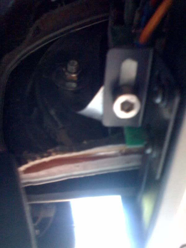

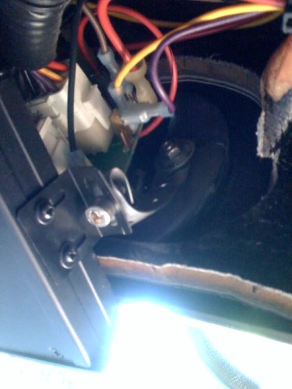

I used this with the lame L-Brackets they give you for mounting. I attached the Galvanized Steel Hanger Strap that I got from Homedepot ($2.50) to the L-Brackets and then hung them from the bolts underneath the dash that are already there. I just bought some nuts to hold it in place. A real cheap way of doing it, and of course its not SOLID, but it doesn't swing around either. Like if you were to jump into the helm and hit it with your knee, it may move rather than breaking, but can easily be moved back. I'll try and get some pictures for you underdeath if you want, as it was pretty dark when I took pictures of it with my phone.
http://i22.photobucket.com/albums/b3...7df4f7_300.jpg
Here are a couple more photos of how I attached the Eq to the dash and more. I would like to take back my comment of it not being solid... its DAMN SOLID, not going anywhere, lol. Pretty cheap, takes 5min, and is very simple.
Port side
http://i22.photobucket.com/albums/b3...0/krypteq6.jpg
Starboard side
http://i22.photobucket.com/albums/b3...0/krypteq5.jpg
http://i22.photobucket.com/albums/b3...0/Krypteq2.jpg
