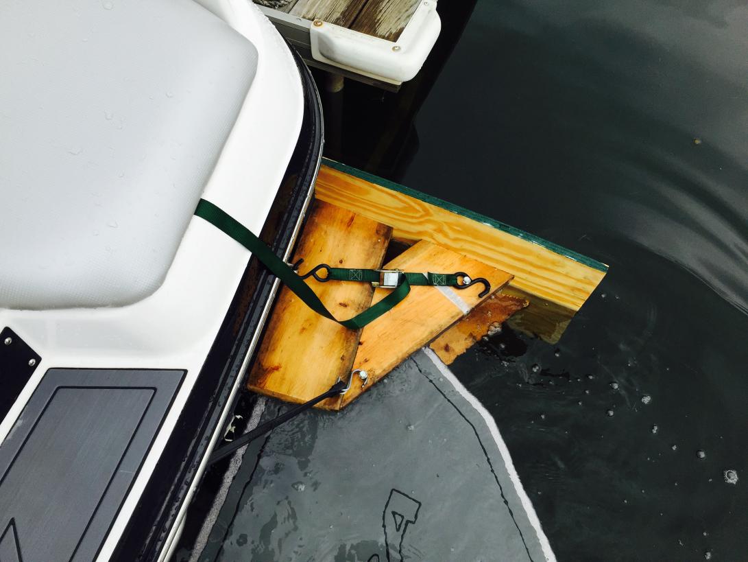

I wanted to thank everyone for posting the details on their Ghetto Gates and how they made them. We made one this weekend I was shocked at how much of a difference it made. We easily gained and extra 5 ft of pocket and a foot of wave height. Wife was super pissed about me "modifying" the boat until she rode behind it. All was ok once she realized how much more area she had to ride around in. Thank you.
post some pics
Attachment 22897
We put it together to try it out. Now that I know how good it works, I am planning to spend the money on black HDPE and make one that will hold up longer and doesn't look as bad when on the boat.

Got my first try at a gate done last night. We'll try it out tomorrow.
Attachment 22958
Attachment 22959
Are you putting anything between the gate and the hull to keep it from getting damaged?
Looks great!
