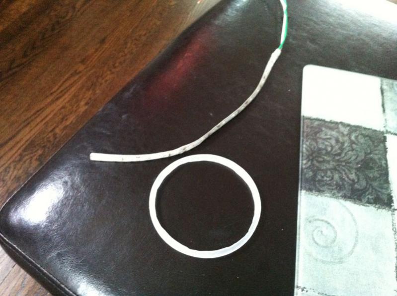

Once I had the rings figured out I needed to shorten the LED strips - easy enough, I just had to cut them to length and solder wires onto the ends;

*Not pictured: I used a coarse sanding block to give the acrylic a frosted look, and remove any rough edges from the router.
Ready to mount. the ring and LED strip;

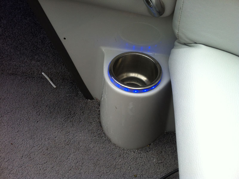

This is where the cup holder rings are a little different than the speaker rings; because the thickness of the ring is less than the LED, I stuck the LED strip directly to the cup holder, rather than gluing it to the ring. Once I had the LED in place I slipped the ring over top, and gave it a test fit;
https://forum.moomba.com/attachment....7&d=1334593938
Once I had each cup holder setup complete I just had to go into the boat and put them in place. I secured them with 3M double sided tape;
https://forum.moomba.com/attachment....8&d=1334593948
And a shot in the dark;
https://forum.moomba.com/attachment....9&d=1334593954
Mounting in the fiberglass was a little tricky - I had to cut a bit of a slot for the wires to feed through, as the factory hole is very tight and wouldn't allow the cup holder to sit flush due to the thickness of the wire - I guess if I used smaller wire this might not have been an issue, but it was an easy enough fix, and you can't see where I had to cut because its under the lip.

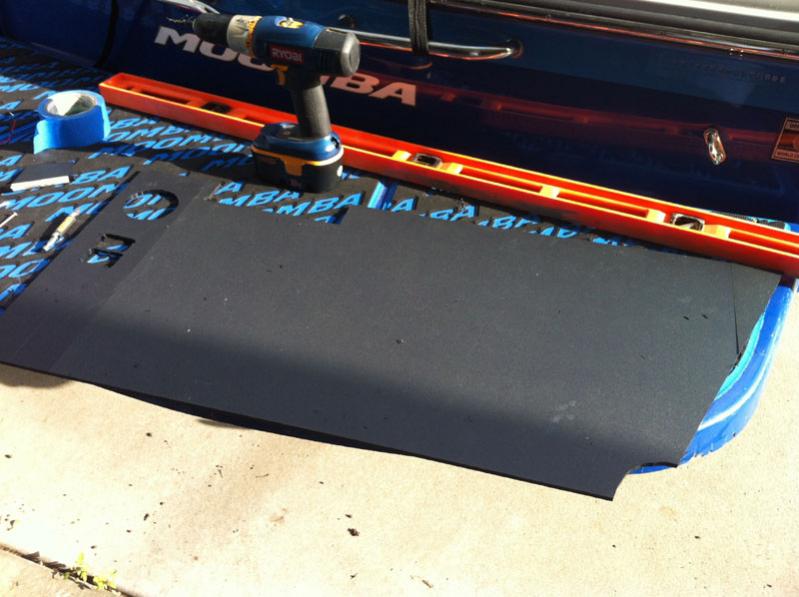

Yesterday evening I dove in to re-making the faceplate that will cover my sub box, as I didn't like how the previous attempt came out. Rather than having the faceplate go on around the subs, I'm going to mount the subs on top of it.

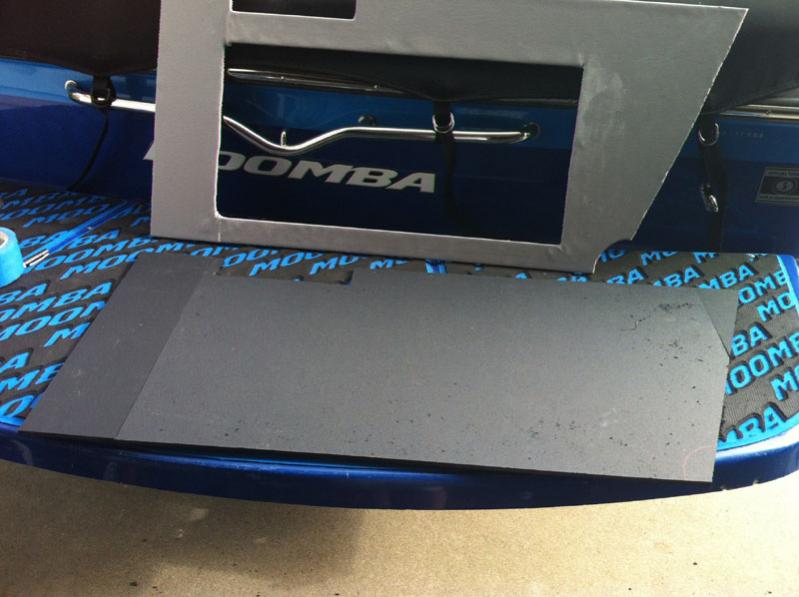

Here you can see the first try - the vinyl looks bad because I messed around with some different boarders, so it looks extra crappy. I used the outline of the old piece as a starting point for the new one. I made 2 flaps on the new one to make it easier to get in and out, as the old one was really cumbersome;

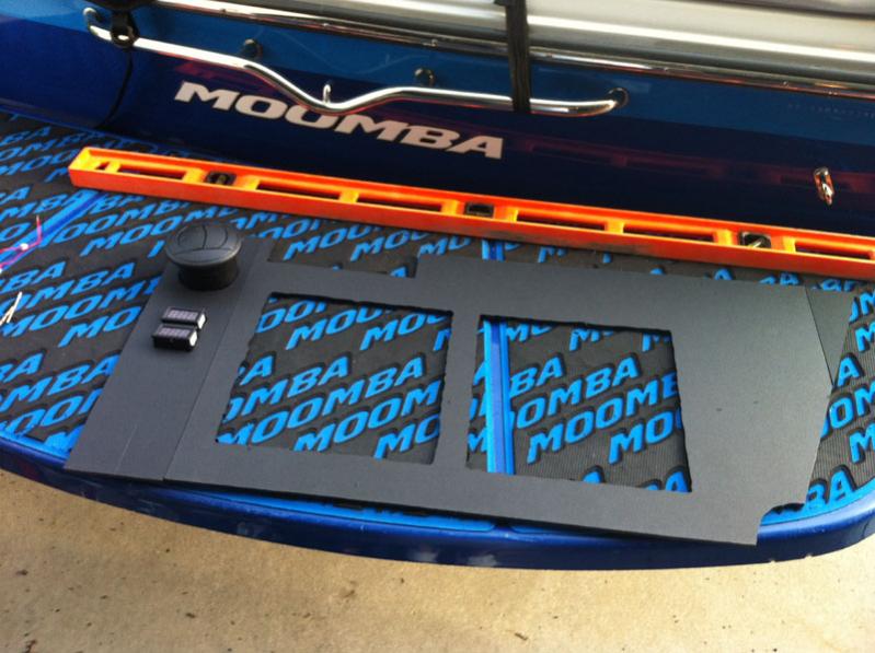

Some of the cuts made, I'm also going to put 2 blue square voltage gauges on a switch so I can monitor voltage between the 2 battery banks when the boat isn't running, which is what the square holes are for. The heater vent will come out of the top;

Speaker holes cut, and playing with the voltage gauges and heater vent;
