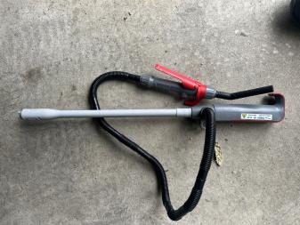

I have been using this it’s called Tera Pump model TREP01. Works great runs on 2D batteries.
