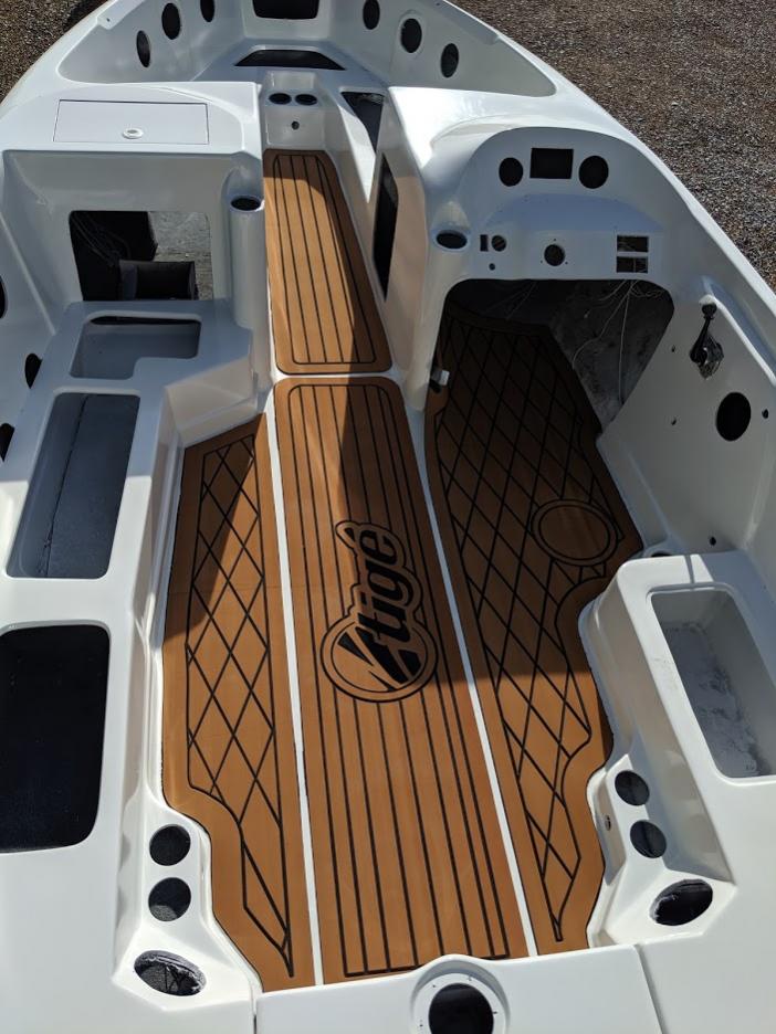

And just for fun here's what I did on my last boat:
It's a bit more, uh, involved lol
