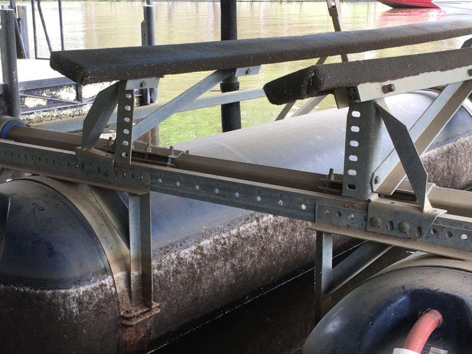

It looks like you might be able to slide the bunks in and out, but limited to the hole spacing in the cross brace. Looks like you might need to loosen the back clamp as well to slide it along the rail.

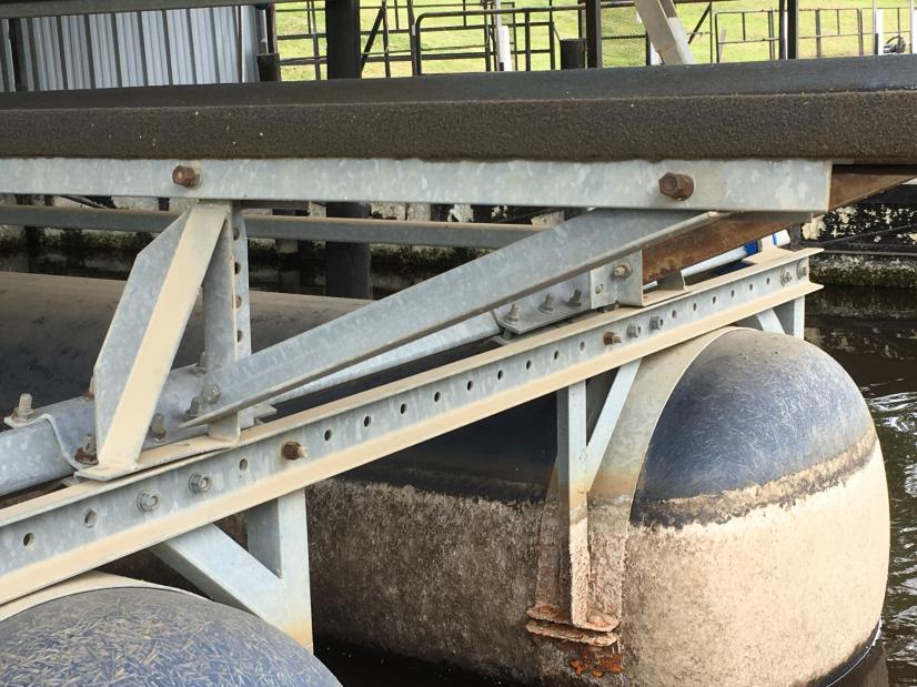

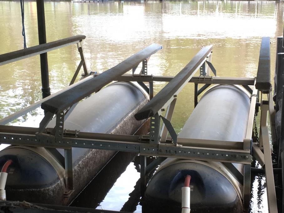

Here is my set up. An older and dirtier and rustier hydrohoist than yours.
26 inches between the inside of the bunks.
30 1/2 inches between the innermost portion of the angle iron bunk support uprights with the multiple holes in them.
You reposition the bunks by removing the two bolts holding the uprights to the crossbeam, then moving the upright to the holes you choose and reinstalling the bolts. Count the holes from center to make sure each bunk stays centered. You can count the holes between my uprights to get an idea. The most important part is to not drop any nuts, bolts or tools in the water.
Looking at your setup, it looks pretty good. Don't override any chines. Check where the chines on the transom meet the bunks.
