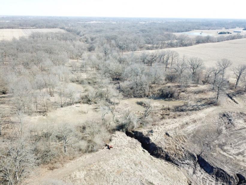

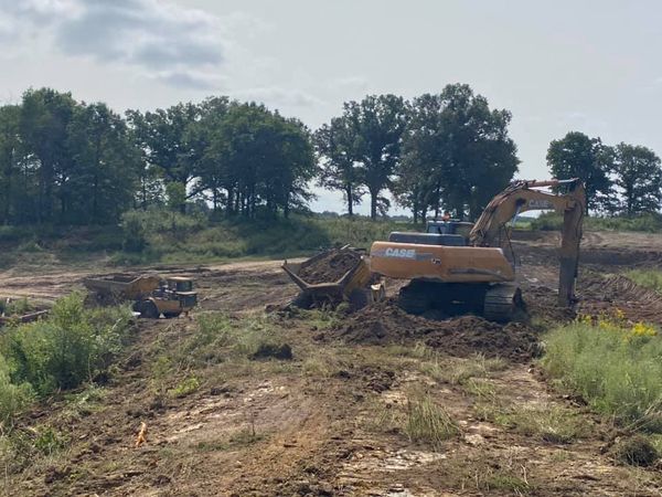

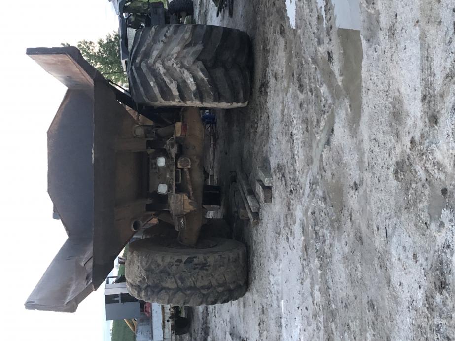

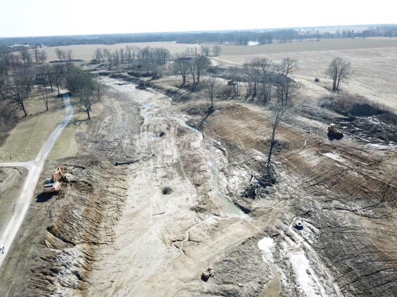

these are some older pics but gives an idea what is going on.
Attachment 28638Attachment 28639Attachment 28640Attachment 28641

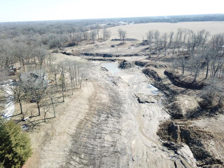

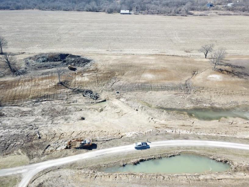

I am going to do another photo dump so you can see what we done the second half of the year.Attachment 29268Attachment 29267Attachment 29269Attachment 29270Attachment 29271
