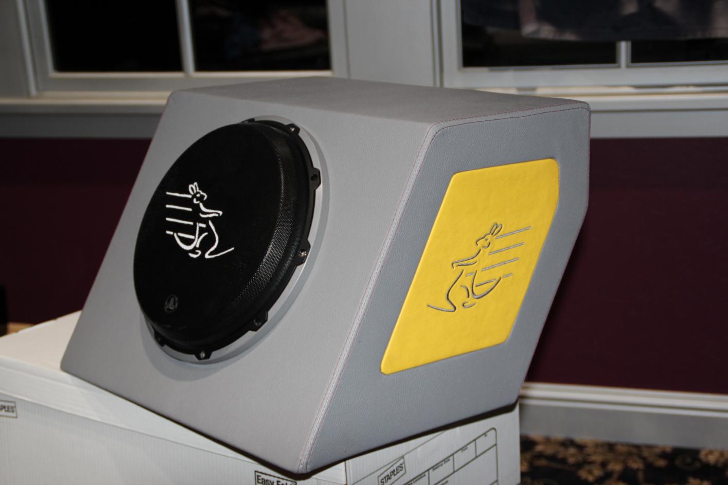

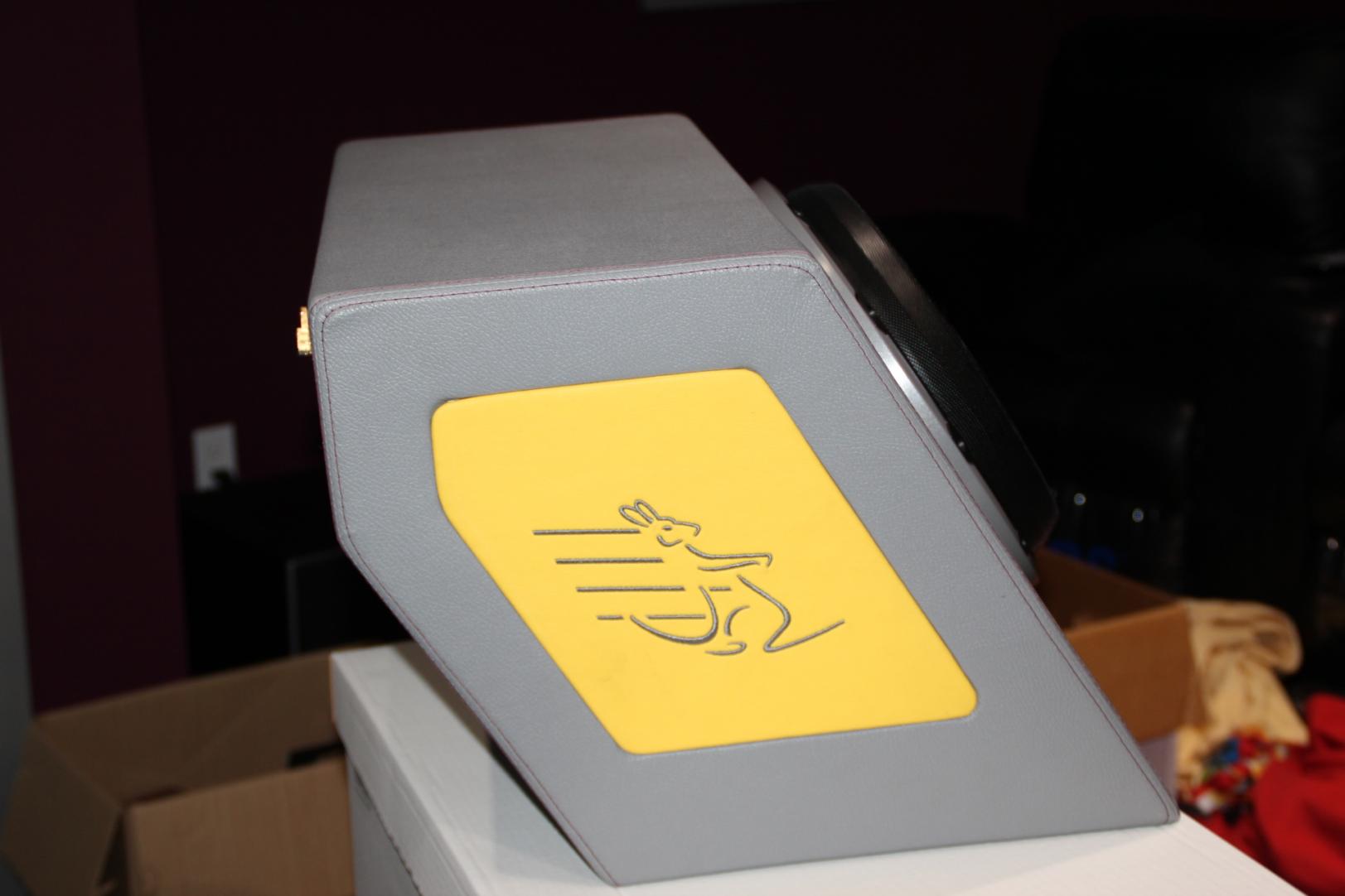

You are doing such a good job, you may want to add in a custom embroidered piece like I did last year on my sub enclosure. Just have a couple of extras made, they are cheap to do.

I'm just copying someone else's hard work which is the easy part, just cut and sew. Adding in or changing anything would be very hard and probably look like crap.. :)
