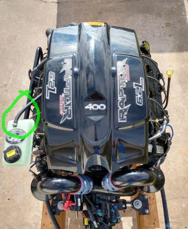

1 Attachment(s)
I had to use this hose to fill the system and bypass an air bubble.
Disconnect and lift up high, use a funnel to fill until bottom of funnel won't drain (it will only take 1 or 2 ounces at a time). Start the boat and it should suck it down and air will bubble into the bottom of the tank once the thermostat opens.
