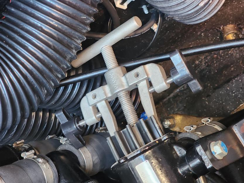

Glad I did the ballast impellers. Replaced with the “upgraded” orange ones from wakemakers. Mine were stock original from 2019, 225hrs, green. Pulled the first 2 and thought I’d wasted my money on the impellers, got to the port side and front and found I had not wasted that money. Impellers look ok inside pump and when pulled but if you bend the veins back there was lots of cracking at the base where veins meet at the hub. Looks like they were at the end of their service life. Both rear bags also not completely emptied, maybe still 5% full. Man those front ones are tight, had to use a flathead screwdriver bit on the end of my small ratchet to improvise a small right turn screwdriver to get those screws out and back in but all in all, not a hard job at all. More time pulling the panels and rear bins and crouching down in the hull, then actual difficulty. Amazing how deep that hull is at the rear.
