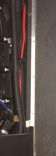

All the '18's in my local showroom now have aluminum from the factory. mine's an '18, must have been either an early build, or a friday build
Attachment 27372
$11.12 @ Lowe’s and it took about 15 minutes total.

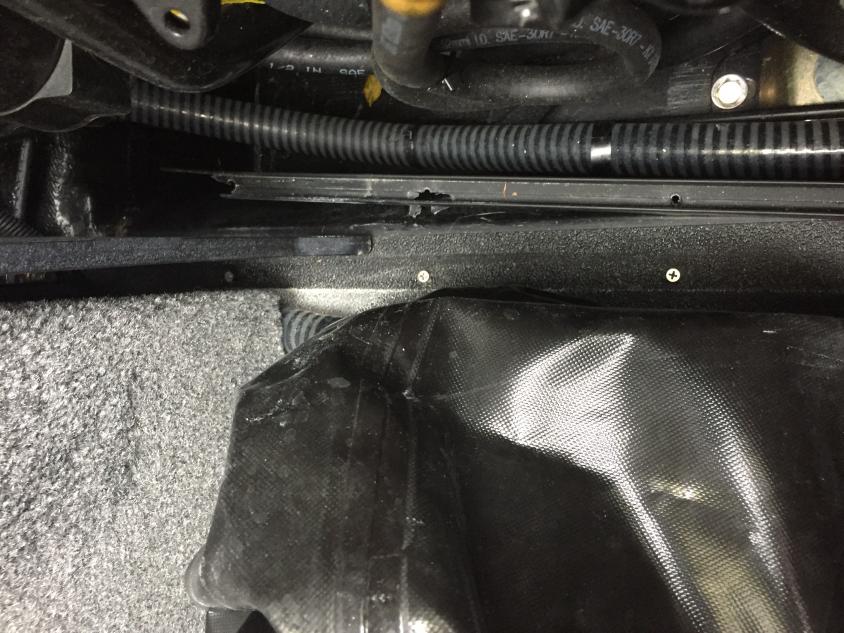

snake has bitten me...my floor channels got destroyed.Attachment 27723
