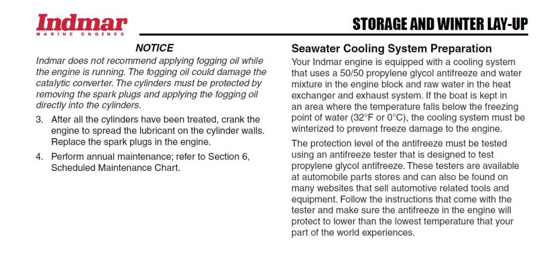

I am curious where you are seeing it tell you to Fog the engine at all?
In the owners manual for the boat for the last Models it doesn't say Fog the engine at all.
Also be aware of the bold print that says any damage from Winterizing yourself will not be covered by warranty.

Page 8-3 in my raptor manual
Attachment 26231
