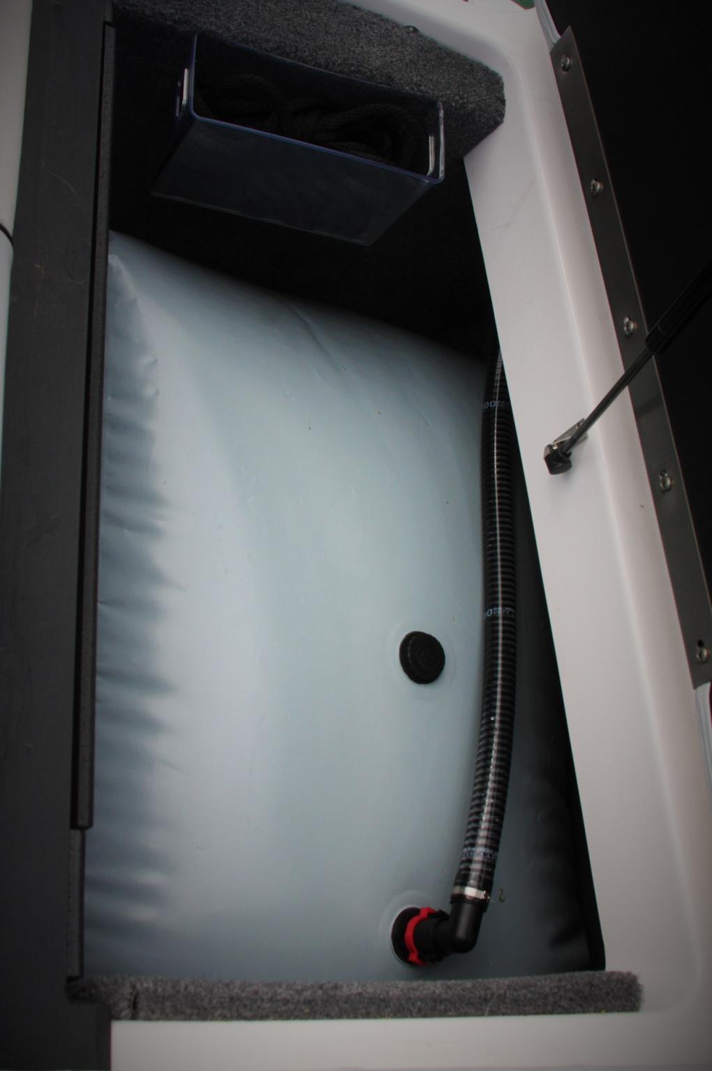

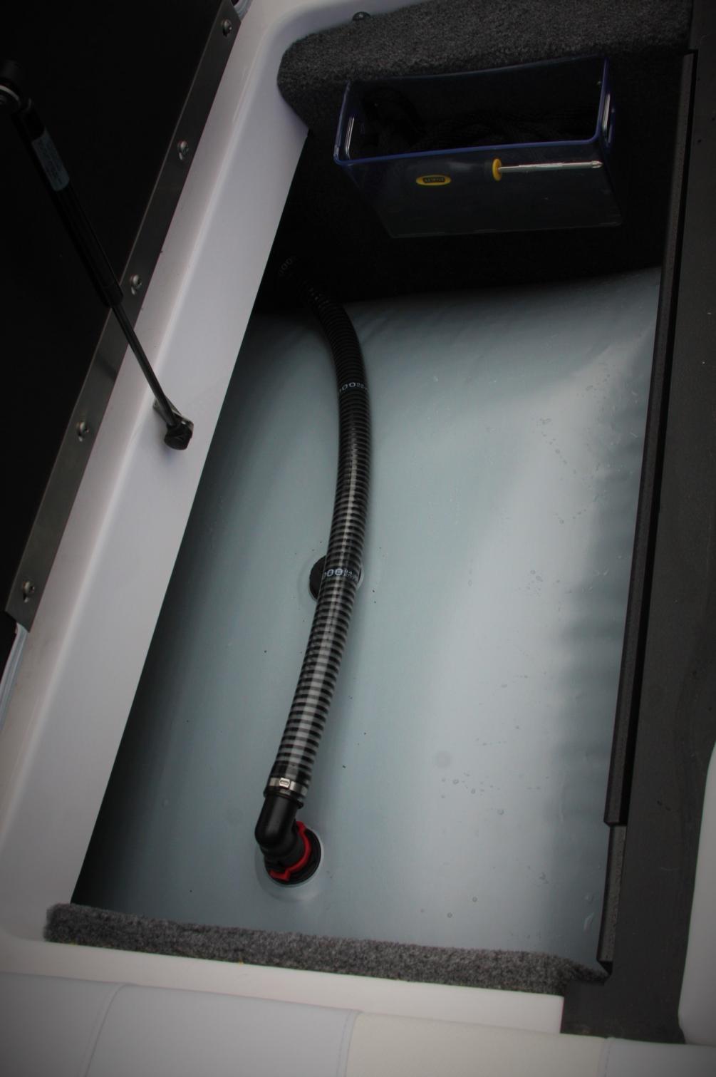

What brand did you get, what was install like as far as fittings go. I want to upgrade the rears in my Craz but like you do not want 1100 was looking in the 900 lb range . Could you keep me up to date on fit while full,
Thanks
If you don't mind me asking why not go the 1100? If you don't wish to fill them all the way just set the timer to stop at 800, 900, 943, or wherever you like. My thought would be that it makes sense to get the one that you may possibly upgrade to later along with some panel savers. Much easier to add some time to the timer than to yet again upgrade bags. Seems like most of us on here have done the 1100s and been extremely happy with them. Just my .02
Yes I here you about upgrading twice I just don't think it's as easy as not filling all the way because the 1100 is 2 inches wider than the 900 so additional pressure is going to be there and am concerned about the pressure on engine wall. Is there any chance you could get a picture of 1100 full showing the pressure, the 1100 would be easier for me as they are in stock at my local dealer.
Thanks

I snapped some pictures with my 820's full and just like I thought they fit PERFECT and I can still put wet jackets on top of them. Made a world of difference in the wake also. Will get to posting the pictures soon.Quote:

820's full with WM panel savers, I know www.marine-products.com has a couple of sets in stock. Not sure if they hit the website just yet. Let me know if you're interested in more info on the bags.
Attachment 24576Attachment 24577
