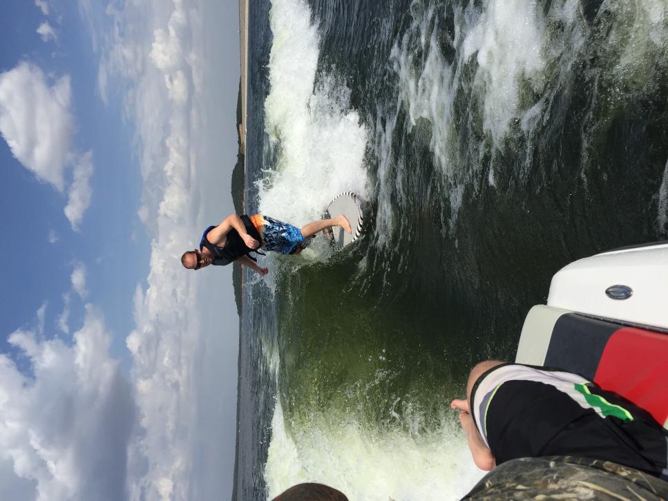

here's a shot of a friend out behind the boat with me driving, we lost almost all the curl at the front of the wave, sever loss of push.. any recommendations?
http://i.imgur.com/af2PjVkl.jpg
i mentioned above, using what i have is not cutting it.. i assume lack of weight in rear is the issue.
i only have have the in floor, the 2 rear 400's (http://www.fatsac.com/FATSACS.bifh) and single 750 (used this solely in rear before gate)
i need to source another 750 for the rear to move the 750's into the rear locker and but the 450 up front in between the seats.
You need the 1100s, that's what i use in my 06.. Full 1100 surf, plus a 400 under the seats and 500-600 on the non surf side, plus center, IBS is optional

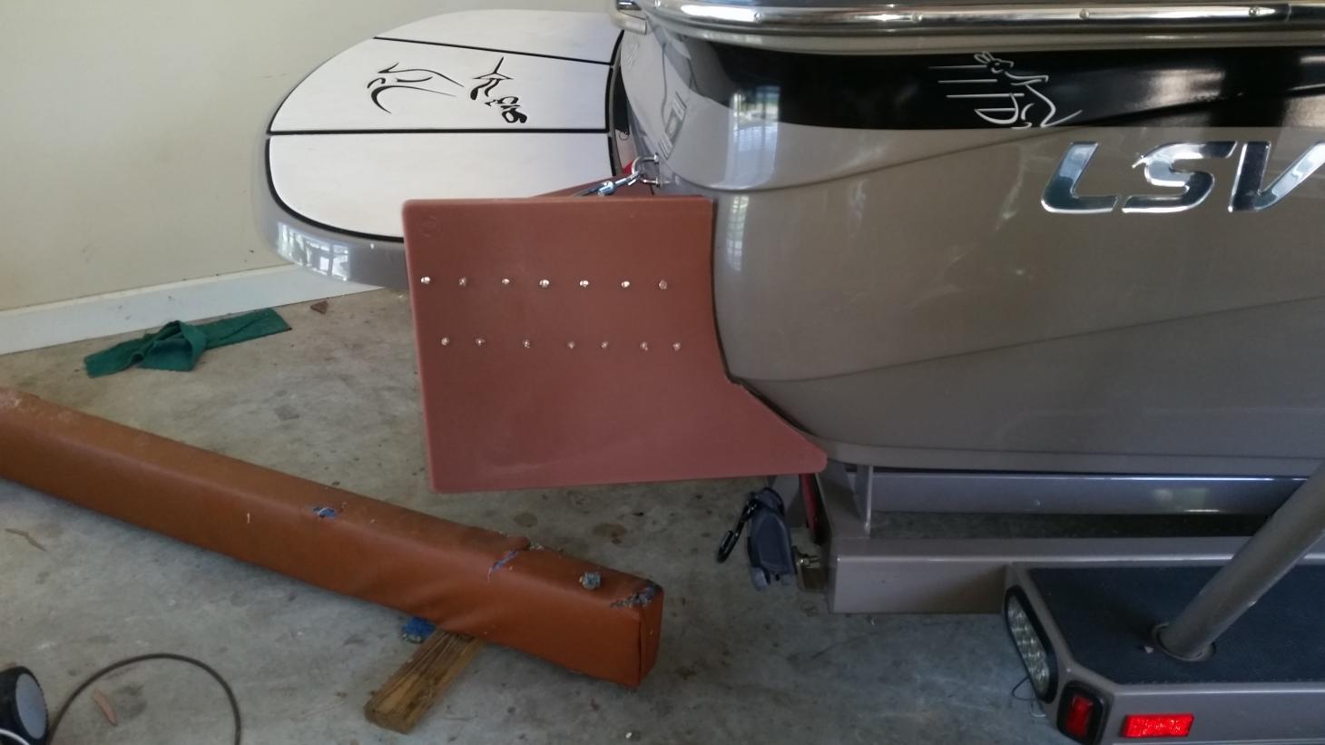

Attachment 22983
1100 port rear, 400 under port middle seats, 1180 bow, maybe 200 starboard rear and the ghetto gate. Need more weight starboard rear, the way was nice when my buddy switched sides
