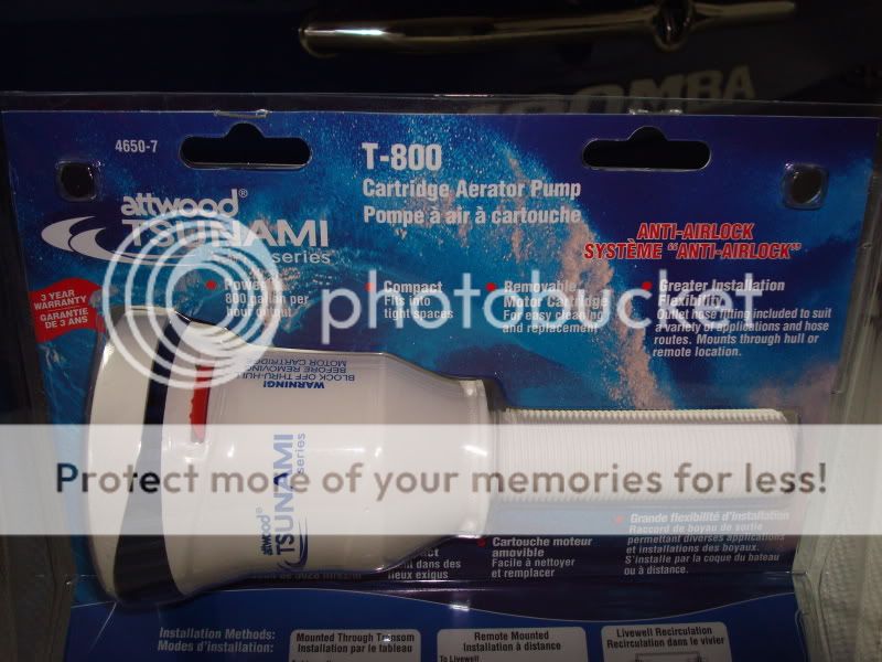

To help empty I bought a second 800gph tsunami pump yesterday at wallyworld and am going to add it to the 700gph pump allready in place, a couple of tee fittings and oneway valves and should empty in 5-6 minutes. Yes it should be a fountain:D
Your Wally's has tsunami pumps? Amazing.
Wally just did some changes and they have a lot more stuff
