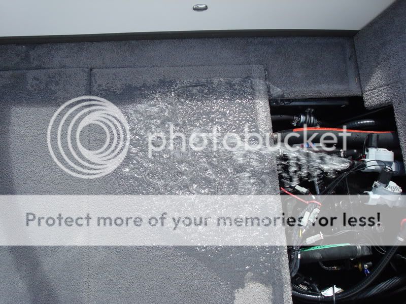

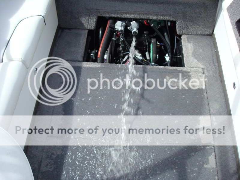

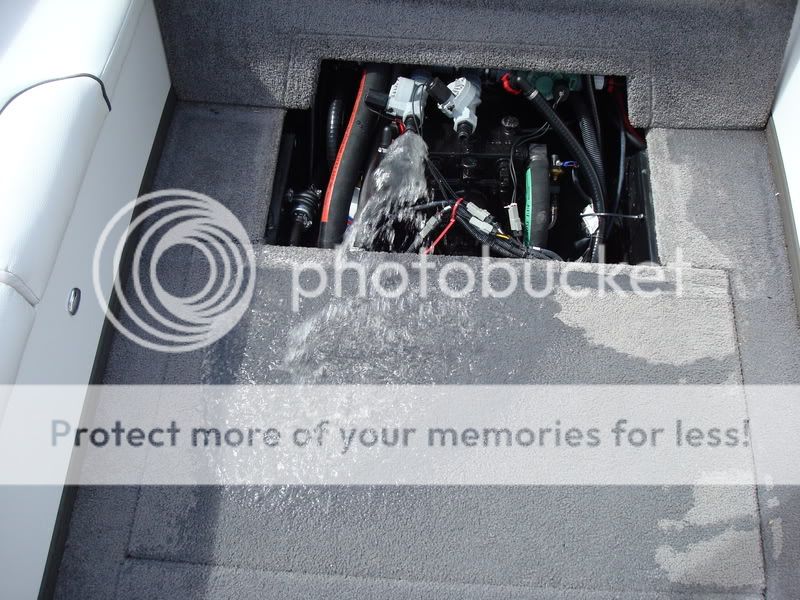

last night, I went back in the boat to figure this out. When the pump is on, nothing comes out of the valve. I put my finger in the output of the valve and pushed on the diaphram. The diaphram went up and out came the water. Could this particular valve not be the right one. Were did you get yours?

Yes I worked the switch while the water is flowing. Remember, the water will only flow if I push the diaphram up with my finger. You can here the difference in the noise the pump makes. Once pushed the water goes into the pump and out the valve.

Alright now. I got it to work. The problem is that I had the pump in a Vertical position in the bucket. The was no pressure of water going into the pump as if it were sitting in the water. I placed the pump horizontal and the water started flowing. Now that problem is solved, the new problem. With the spring out, and solenoid off (no power), I still get a great flow of water. So I reinstalled the spring and powered the solenoid and yes the flow was a lot less. I think the spring needs to be there to put pressure against the diaphram to keep it closed so water will not enter while the boat is in motion. Now, I wonder if we cut a coil or two off the spring and still give the diphram pressure to keep it closed but less pressure when the pump is activated to allow the proper flow. What do you guys think?
