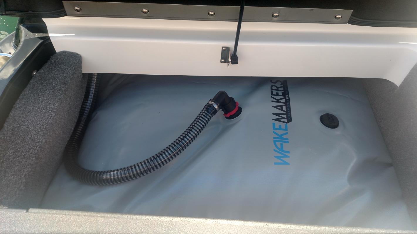

Some pics of the wakemakers 1140 bags, was able to move the bottom of the back wall aft about 5" to help get a little more in. for my craz it took setting timers to 13 minutes to fill , at that it just barely started to come out the vent, should be pretty close to filling the bag full, the ballast puppy is supposed to pump 88 lbs a minute. For the wave in the pic we had both rears 100% center and 500ibs at close to 90 % smartplate 20 % tab at 65% , 2 adults and 2 small kids , 150 sumo under bow filler speed was 10.8 on phone gps , but for surfing it , in order to get enough push for me we had to slow down a little , and bring the smartplate to 0 and the tab to 70 % ,move the sumo to the back, a few times we brought the smartplate up to 25 , but really started to loose the push. Had about 2 board lengths of surfable wave. But was a really great wave was able to pull of my first 360 , so just some more info for those us still getting used to setting their boats, lots of trial and error , but a blast none the less.Attachment 25789Attachment 25790
