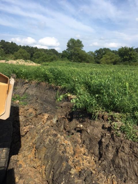

Bring in the heavy civil trade, this is a pretty cool project. Use to deal with Hanson all the time as well which is now Forterra. Best of luck!!

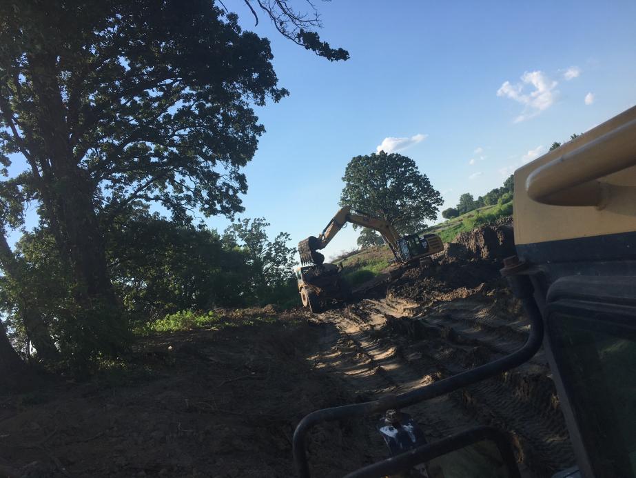

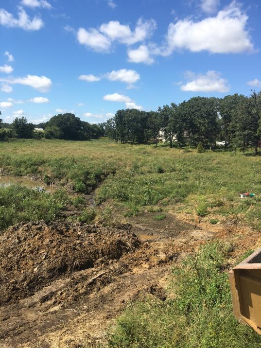

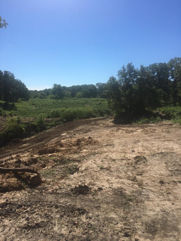

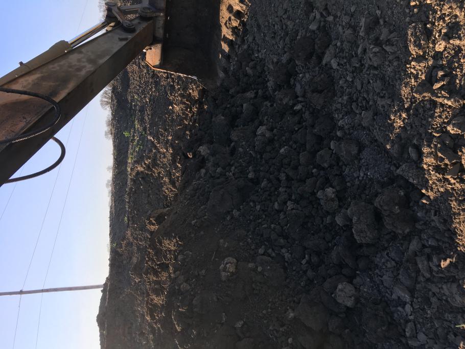

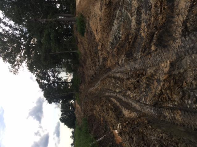

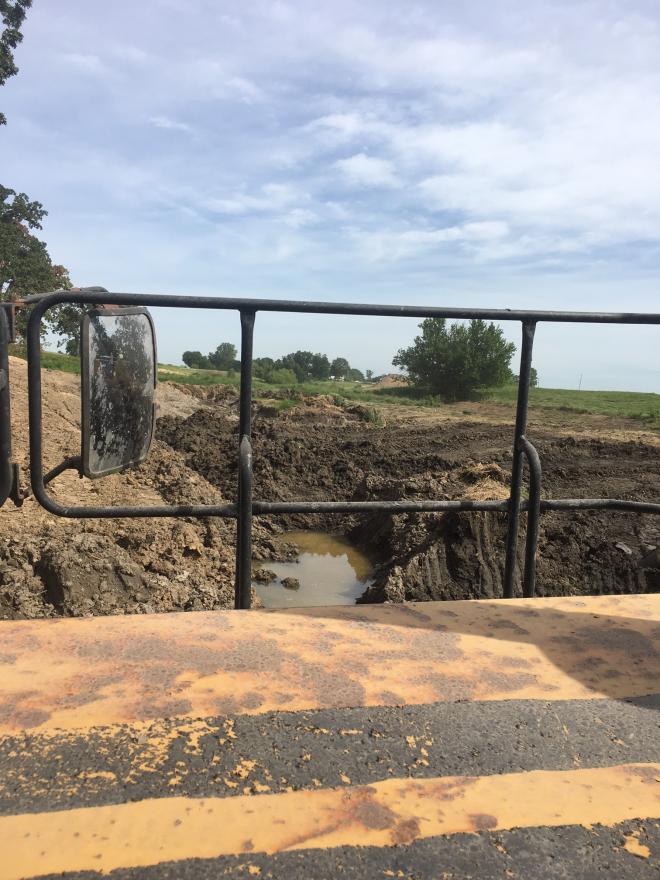

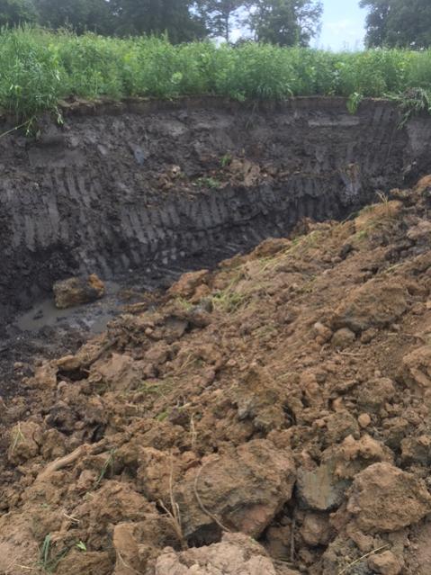

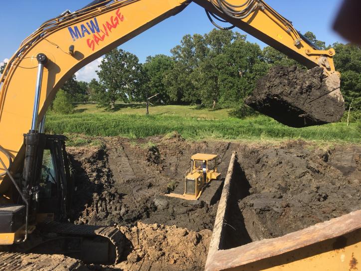

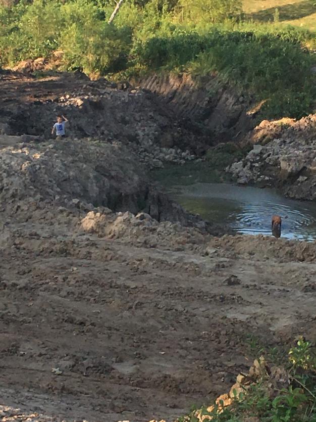

Looks like it is getting deep!

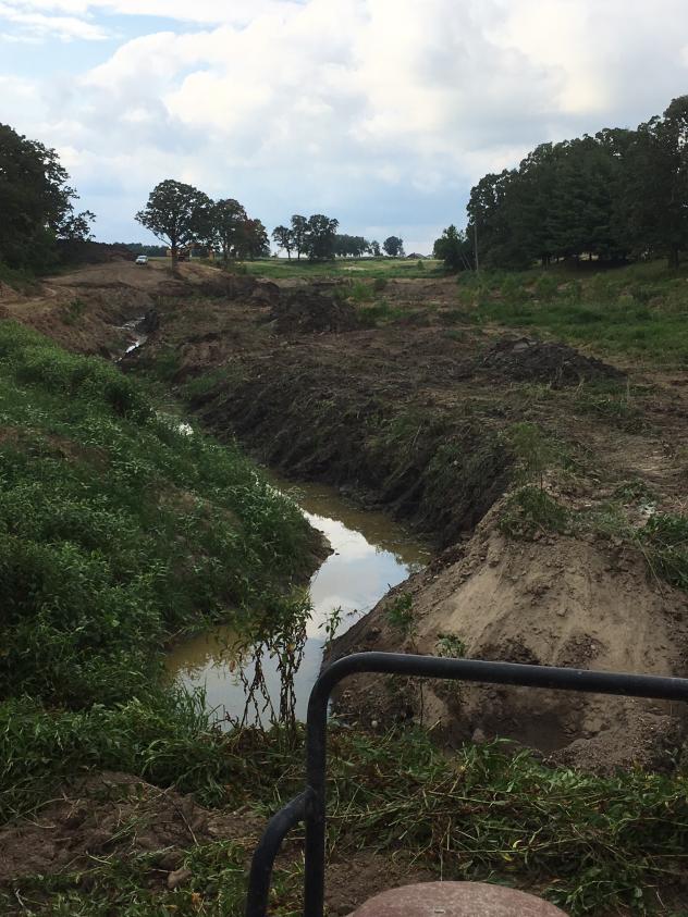

yes we had to cut a ditch to the dam and through the dam to de-water the silt. We were digging 12' deep in the silt we still were not hitting a hard bottom. so we had to lay a clay road to get a cut to the dam. that will make that area over 20' deep. ( we will not move all this dirt, we will move what we can afford and have room for on the dam end. it is already close to 10' deep.

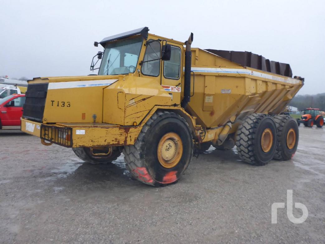

I went to an auction Friday that I should of not went to and end up with another toy to help on the lake build I could not pass it up for the price.
Attachment 25430
this will make the third haul truck for the project.

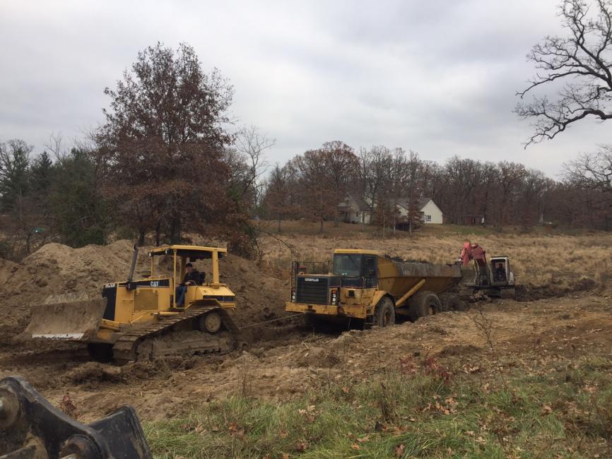

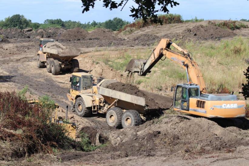

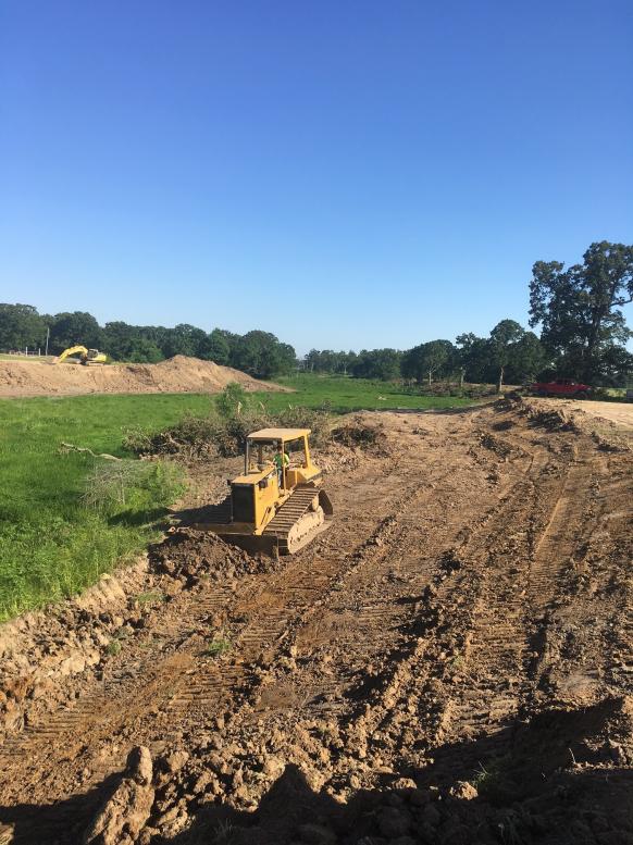

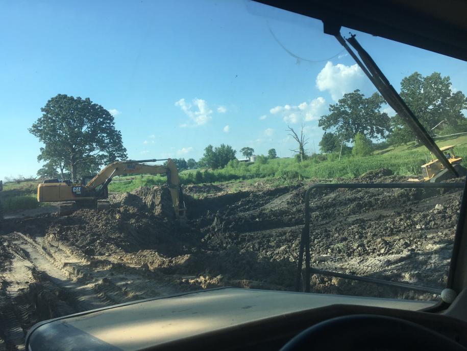

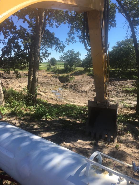

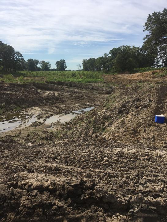

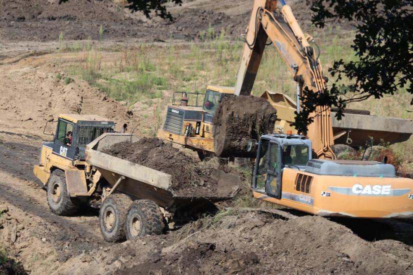

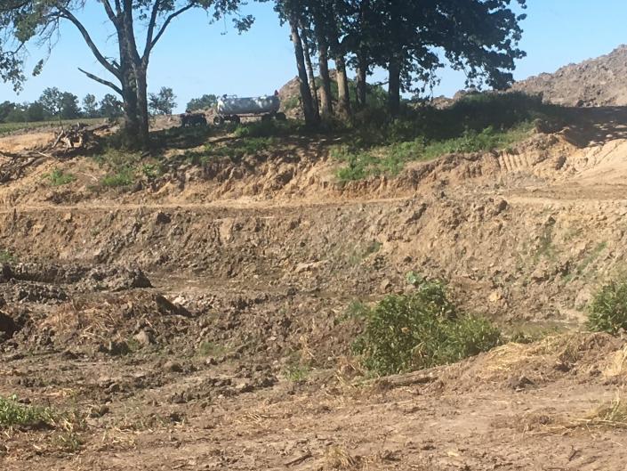

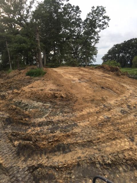

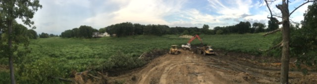

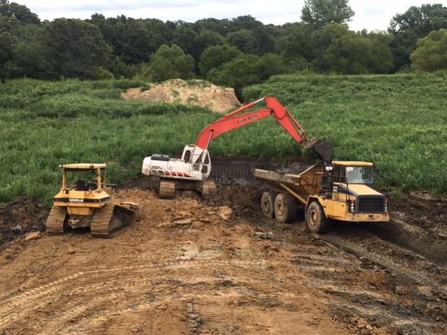

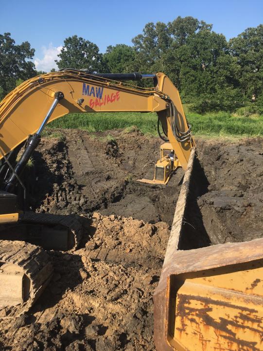

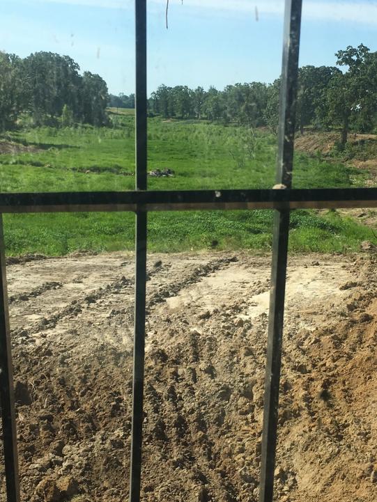

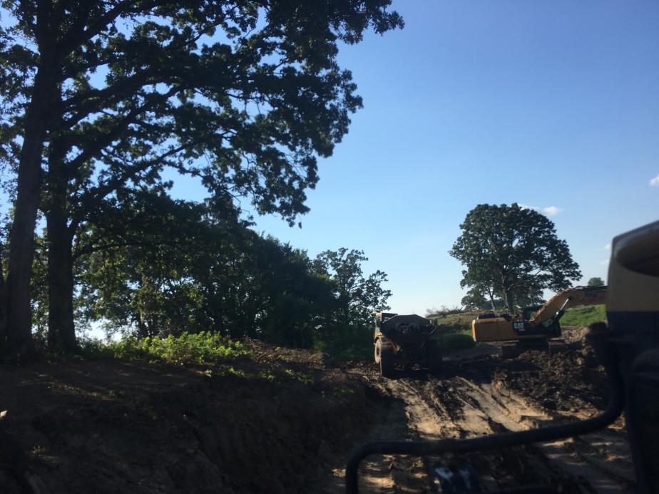

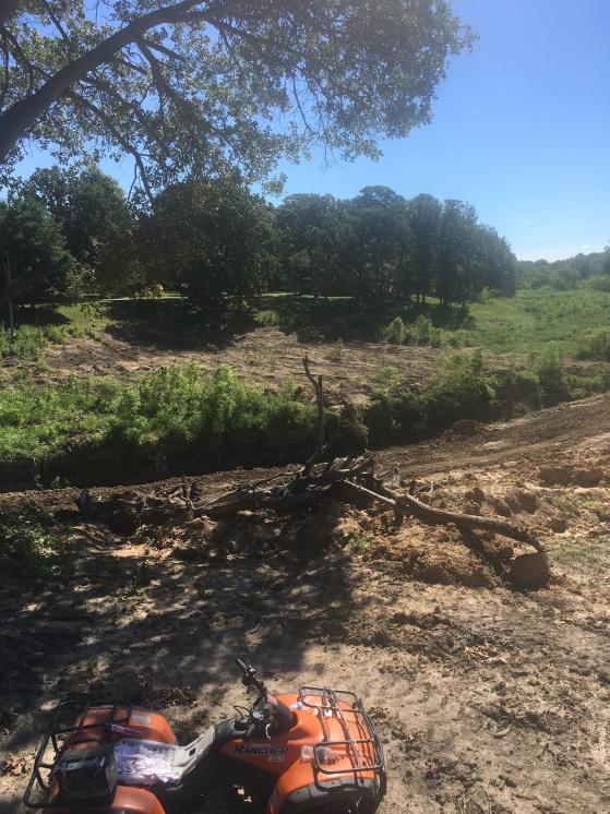

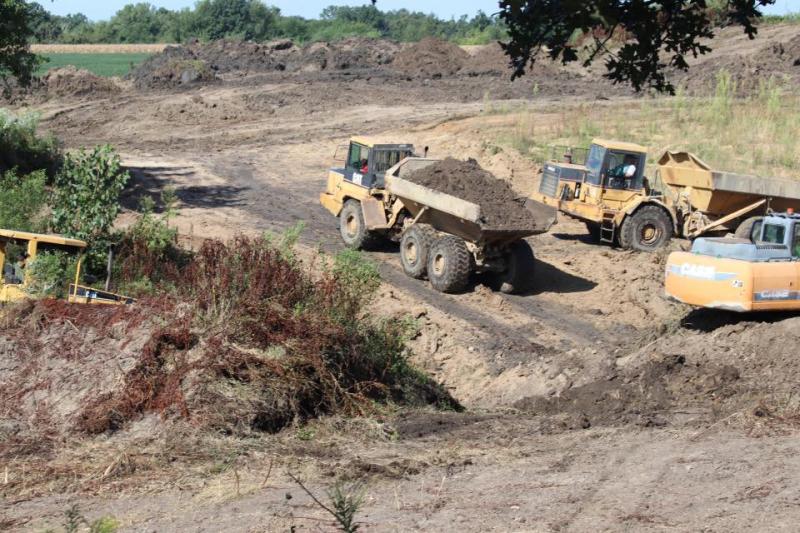

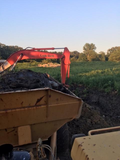

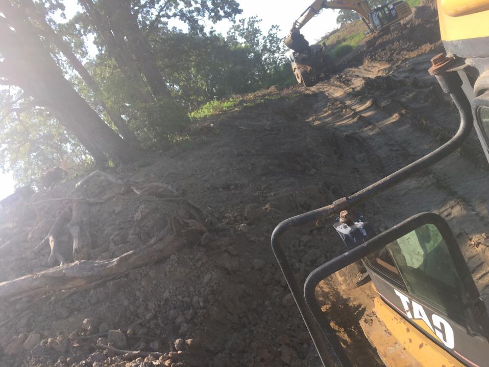

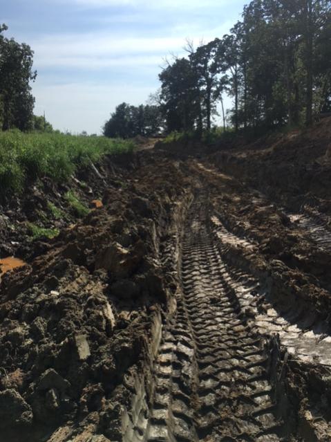

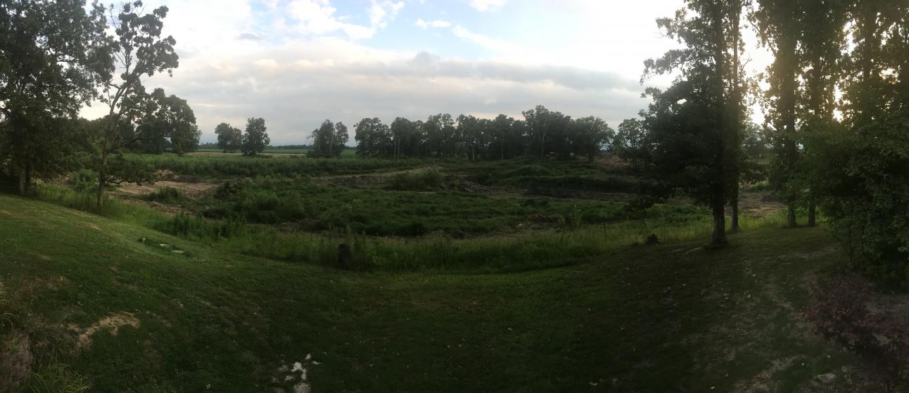

Been doing a little more digging. I am currently have a second track hoe out at the place. thing are starting to come together.
We tore out a bunch of trees.
We been building roads around the property with clay off the edges.

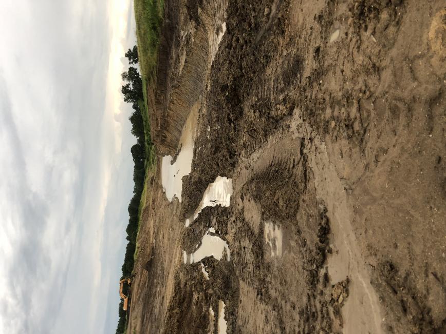

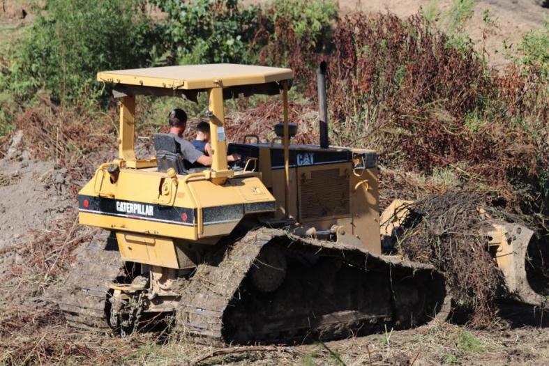

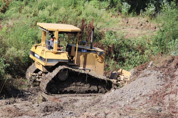

The silt in the existing pond is starting to get dry enough we can push it with the dozer. (just need a bigger one now)
The equipment been holding up for the most part only minor repairs so far.
The Railroad contractor fell through on the dirt they were going to take they missed there estimates by 80,000 yards. (the wrong way)
But I have picked up another contractor who's digging 10,000 yards for a bridge project. I also have a second contract needing 10,000 for a project he bid but is waiting on getting start. (Got to love the IL budget these are state projects taking the dirt so everything is shut down till the finalize a budget)
Here is some pics hope you enjoy

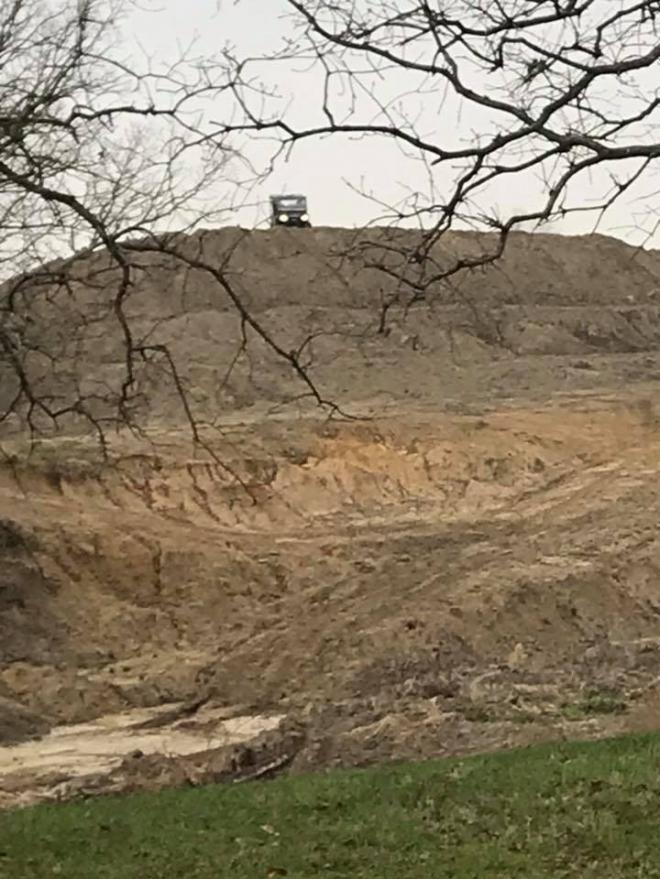

We Ran Clear up to the week before Christmas than it got to cold and we quit for the winter.
We got a lot to done in the last couple months.
if you are looking at the lake from north to south we have the 6' more to dig for the north most 400' that will incorporate a turn Island in it.
and we have from 400' mark to the 1800' mark 80 percent done. Then we have to shave 4' out of from the 1800' mark to the 2600' mark.
there is a lot left to do.
New lake completion goal is by the end of 2018. I think this is very doable depending on how wet of year we have.

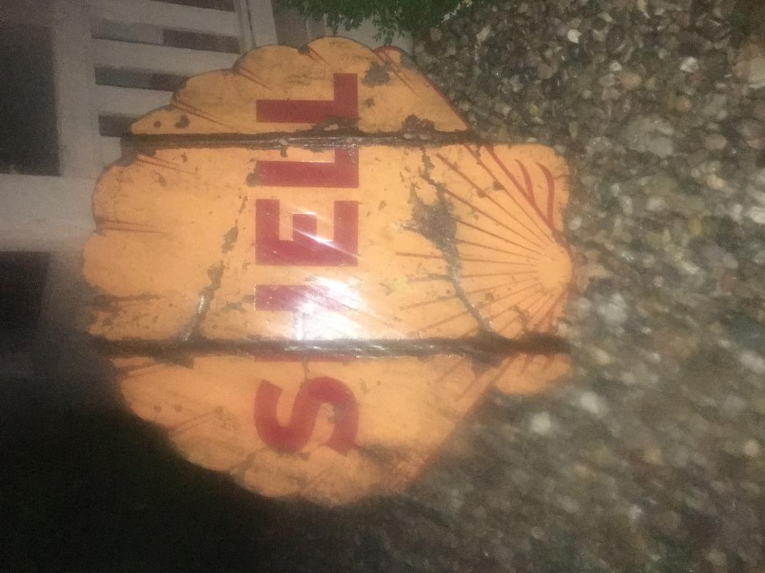

I did find a cool 5' tall sign about 6' under the dirt here is a picture of it it was folded in thirds when I unfolded it just has rust lines where it was folded

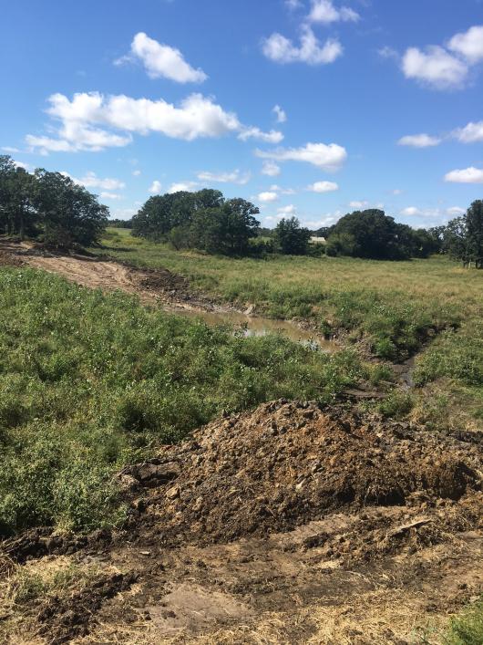

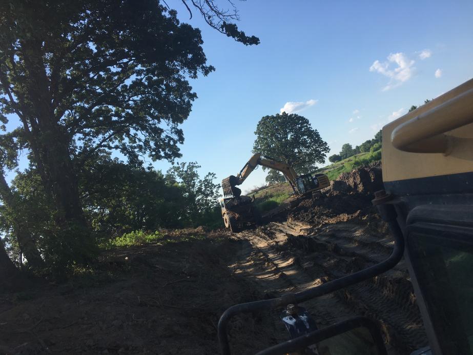

Well Lake building for 2018 did not go as plan. I took a new Engineering Job in march. This stop me from spending the extra time on the lake that I had planed. (Life got into the way of building the lake but it will happen with a wife and 3 kids at the age of 4, 5 and 8.) But we did a few cool thing around the project my 5 year old had a dirt birthday party and all the kids loved it
We got a lot done but still have a lot more to go.
We put in 3 silt ponds and 3 dry dams to contain the water flow into the lake.
New goal is the end of 2019 and hopefully wakeboarding on it in 2020.

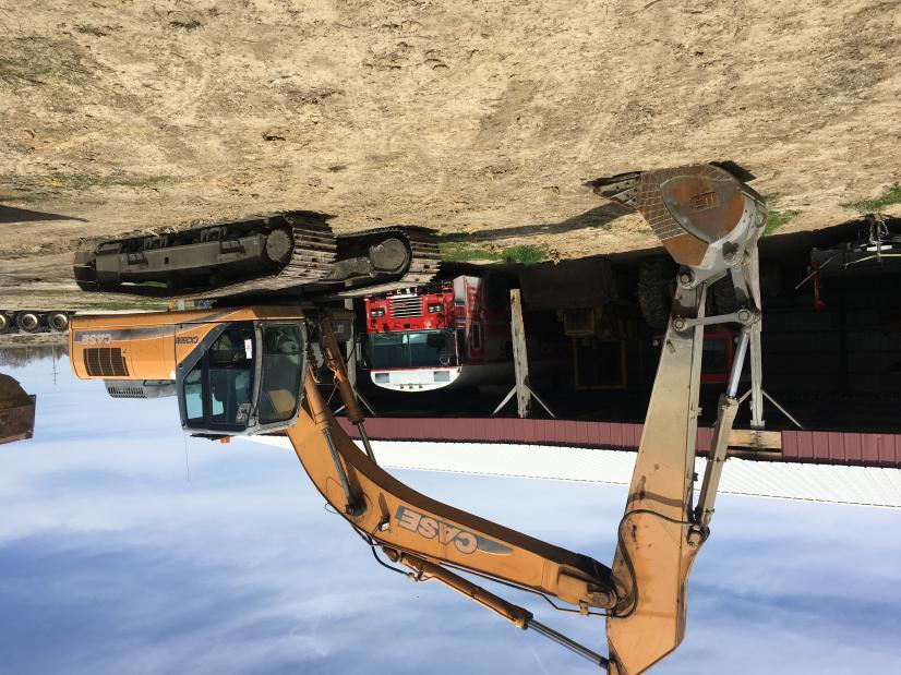

I did add a 2008 case lx350b trackhoe and a drivable compactor to the construction fleet this year.
We came up with a potential name for the lake this year.
WTF - (Wolff's Training Farm or Wakeboard Training Facility) or it could just be what my wife and neighbors ask me all the time What The F are you doing.
Here is some pics through the year.

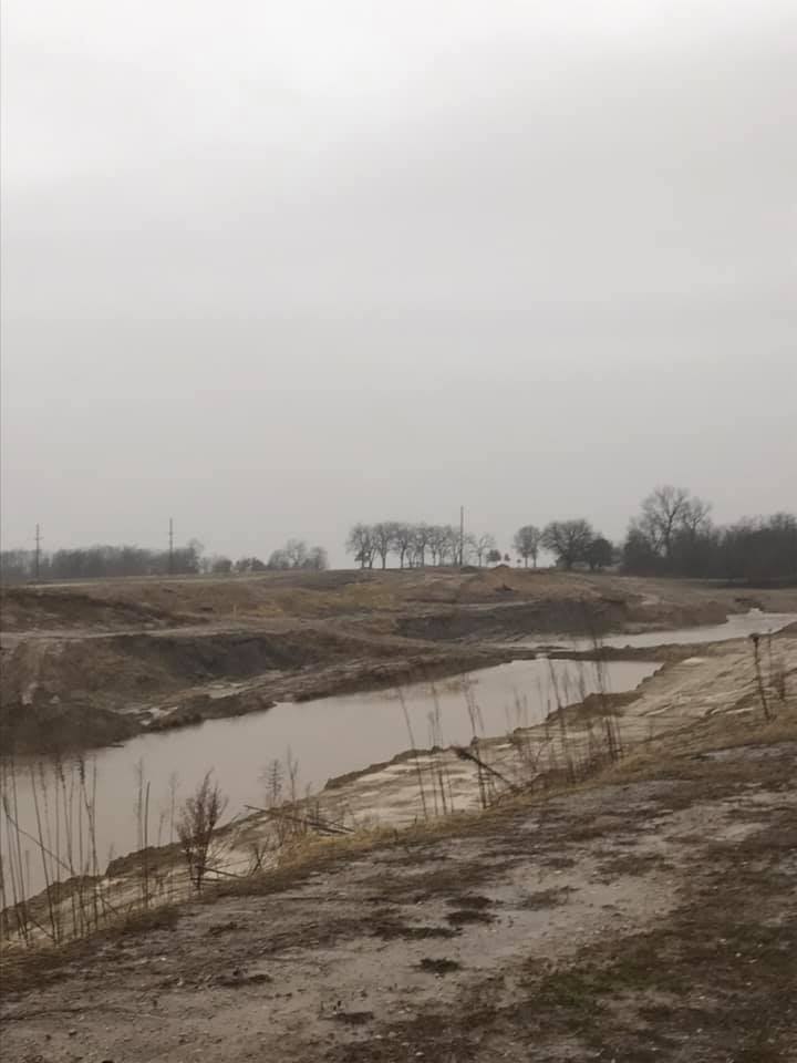

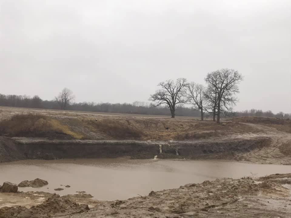

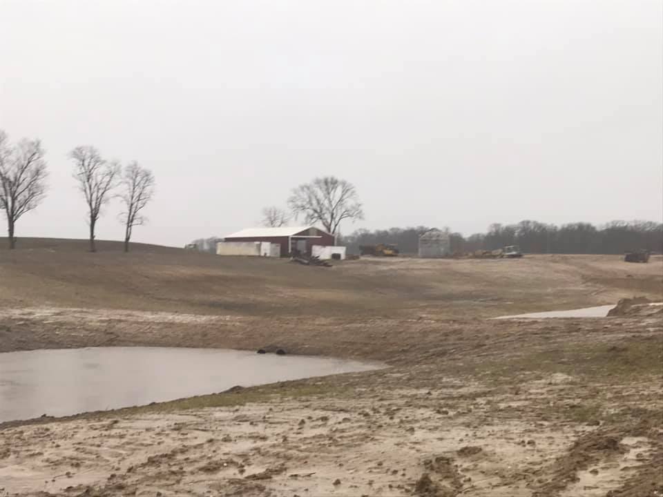

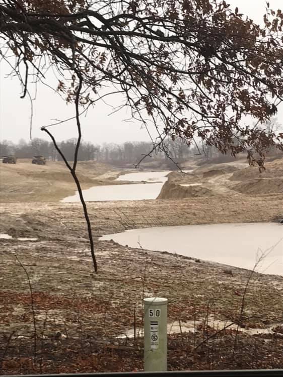

end of December we got a 2" rain and we had about 4' of water flowing through the lake bed.
