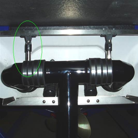

Here's a pic of the FAE Quick Release that FAE sent me:
https://forum.moomba.com/attachment....9&d=1390486959
Attachment 19119
There's also tons of pics on their website.......www.freshairexhaust.com
If your garage space is so tight you have to remove the FAE each time, its not real difficult, just a couple band clamps. Kaneboats is correct though, the FAE does still extend 6inches apx past your wake plate, this is the Down Tube.
