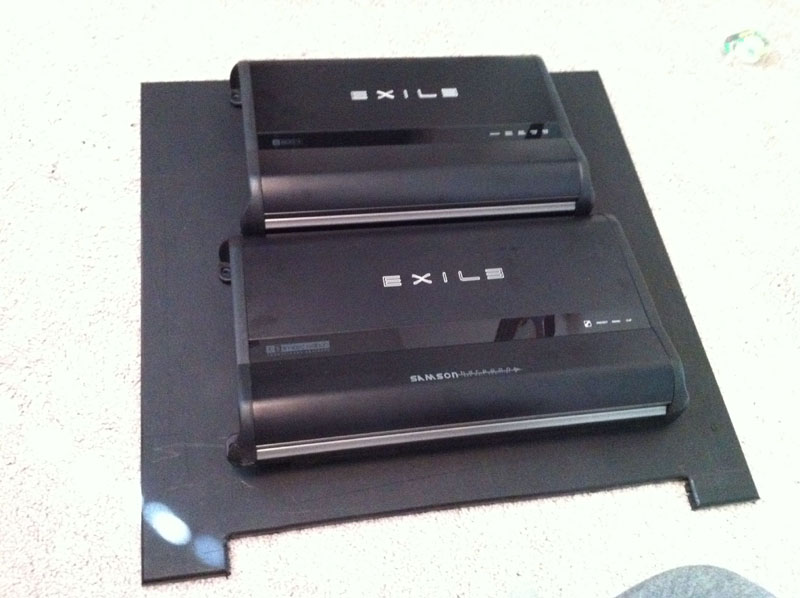

I cut the board to 24"x24" and decided to mount just the Exile amps on it - the Kicker will go on the backside of the bow seat, above the battery box. I cut out a channel to give the appearance of 'feet' on the board, and used a router to round all the edges;
https://forum.moomba.com/attachment....2&d=1331504501
https://forum.moomba.com/attachment....1&d=1331504499

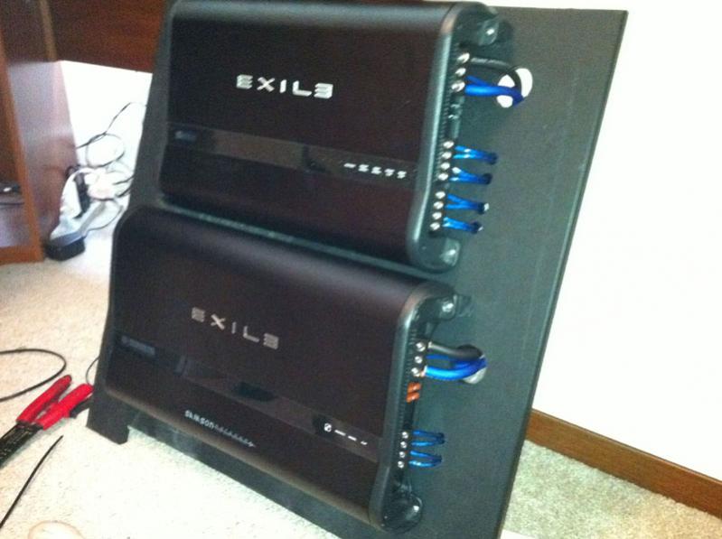

Instead of mounting all 4 corners on 1" pedestals I decided to stagger them, with 1" rise at the top, and nothing at the bottom. I think it looks pretty cool;
https://forum.moomba.com/attachment....3&d=1331504502
The backside of the board; I ditched the idea of displaying the distribution blocks - all that I have left is to run RCAs and the 1/0 from the distro to the batteries;

It is looking really sharp. Are you going to mount the amp board in front of the battery box?
This one will go on the outside wall, its the only place that fits everything and is out of the way.

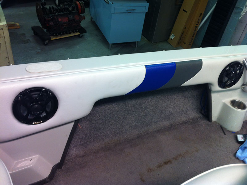

Cabin speakers in their factory locations (I used to have them on a separate panel in that opening under the stripes:
https://forum.moomba.com/attachment....2&d=1331906136

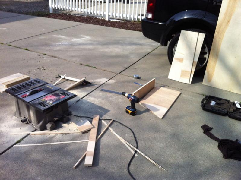

I spent some time working on the sub enclosure this weekend - a little more time that I expected actually, lol. I decided to go with Birch wood for the box, instead of a synthetic material. The reason being that I was completely winging the measurements with the compound curves, and at $18/ft using Starboard or similar would yeild some expensive mistakes.
What I've come up with is about 2.4 cubic feet, that will have an external port tuned to ~35 hz, and house 2x 10" Kicker L7s. I decided to go this route at the suggestion of Phil from Kicker.
My work area - it was so nice out I decided to drag my tools outside and work in the driveway, rather than my basement;
https://forum.moomba.com/attachment....7&d=1332168163

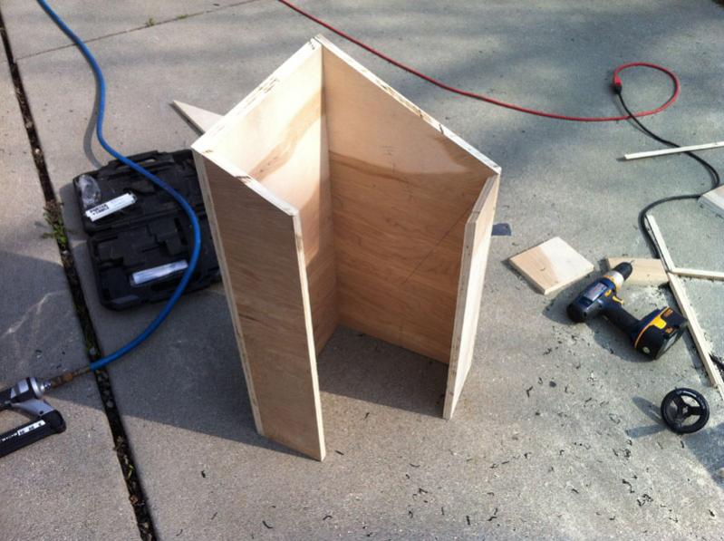

Piecing the box together - this is where I made a crutial mistake that I didn't realize until I tried to put the box into the boat - what is the mistake...
https://forum.moomba.com/attachment....8&d=1332168164
https://forum.moomba.com/attachment....9&d=1332168166
...the mistake was that I built the box backwards, LOL! Fortunately, I did not glue, and only used the pnumatic nail gun, and hadn't put in any batons yet - so all I had to do to correct was pry it apart, pull all of the nails, and re-build the correct way. I need to cut 2 new pieces based on the angles, but that won't be an issue at all;

Once I get the sides cut I'll get it in the boat for a test fit and mark where my port will go - I'm thinking that it will come out of the top left side, and vent forward, but I need to measure the clearance before I start cutting.
Lol I was looking at the pics before I read the post and though to my self "how in heck is that going to fit under the dash".
That sucks, sorry man.
How many cubes you getting out of that box? You doing a slot port?
Speakers in the panels look really nice. Nice work so far. Cant wait to see the 3 Transome LED's in the water.
It's like 2.4 cubic feet, roughly.
Slot port through the top, facing forward.
I am going to start the LEDs once this is done, hopefully by the end of the week :)
Thas going to be tight for 2 L7's. It's still going to part the hair on your legs!:p
I thought so too, but Phil said I should definitely run both subs ported, rather than single ported or 2 in sealed. Since he is the man, I figured I'd run with it!
Good call!

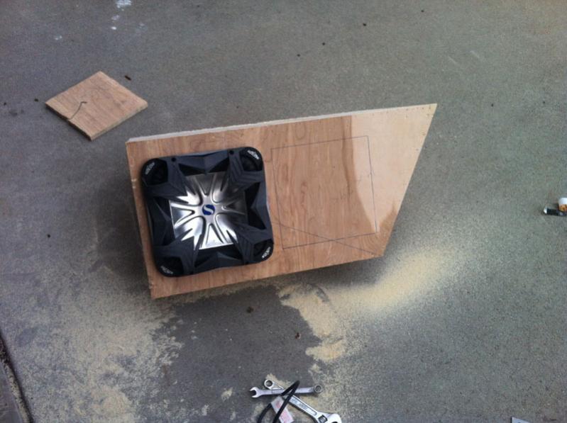

Some more work done on my sub box - I got it rebuilt the correct way, and also cut the holes for the woofers and the port. Next step is a final test fit, to build the port, resin, and rhino-line.

Dang... that is some good work... it's a shame that pretty wood has to be covered!
Meh, its trick photography! I'm a pretty big hack, lol.

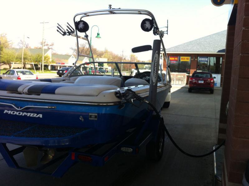

Filling up before hitting the water - the XM9s with their wetsuits on :)
https://forum.moomba.com/attachment....7&d=1332780525

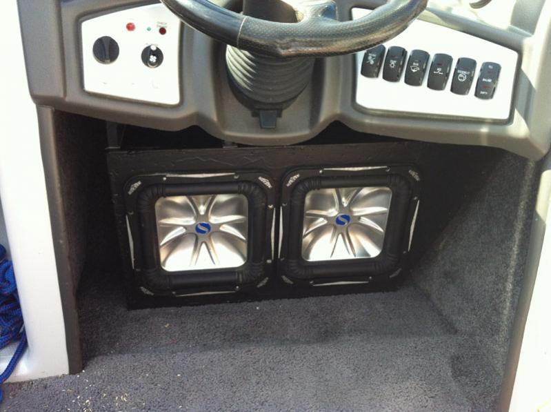

The subs installed - I still need to make the trim piece to cover the box, that should be done this week.
https://forum.moomba.com/attachment....8&d=1332780526
Looks great. I'm digging the side by side subs alot!
Looks great! I have a kinda off topic question... looking at your picture of gassing up. I never get mine over 3/4 tank so fuel doesn't come out onto the boat... Judd (who I bought the boat from) taught me that. Am I the only one who does that?
As far as I know, yes, you are the only person I know that doesn't fill their boat all the way up with gas. I ususally fill mine until it's spilling all down the side and into the lake, wrecking the delicate marine habitat and ruining the water for everyone.
That would be a 13 gallon safety net here. LOL, no I def don't do that. I'd think you are still leaving 10 gallons on the table?
You can listen for it or put some paper cloth around it. The place I usually stop at is actually pretty good about the clicker catching it.
