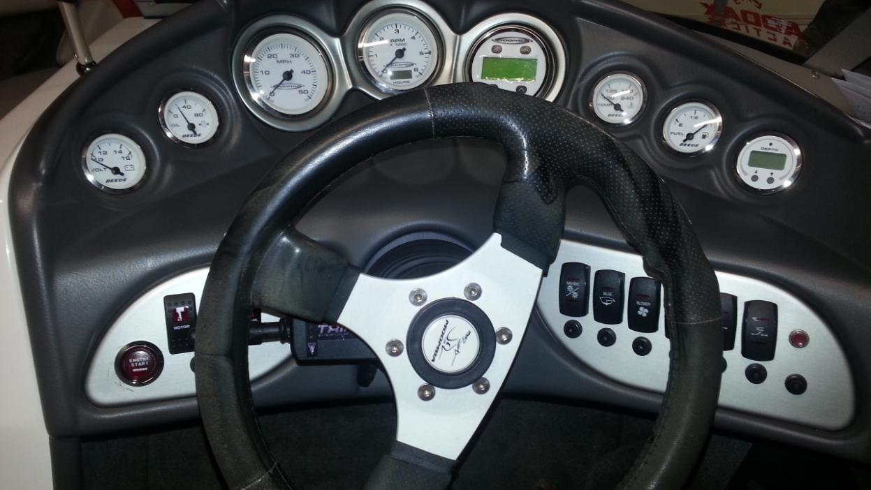

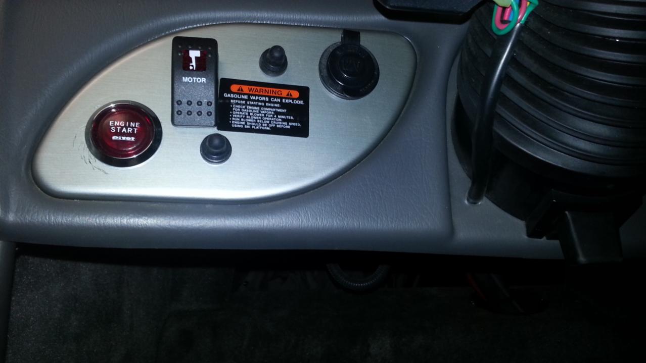

So my ignition switch failed on my last weekend and instead of putting in another key switch, decided to try out push button start. Here is what it looks like, haven't used it heavily yet so not sure how long it will last, but giving it a shot. Longest part of the job was waiting for the parts to come in. I decided not to worry about the theft part of it, as many said, takes but a few min to defeat the key switch, and I store my boat in my garage anyway.

Your going love it after switching mine over last year I will never go backwards. Even if I get a new boat I will do this asap.
I like how it looks! Let us know how durable it is.
Where did you pick this up or what brand is it? I love the idea of it.
Brock
Found both the engine labeled switch and the push button start on that big internet auction site, think it was less that $30 for both shipped. If you do it let me know and will send you the wire diagram I used, the one that came with the button was really bad.

Thanks guys, the only thing I might add is a secondary hidden lockout switch.

My push button switch had a confusing wire diagram and color scheme as it had 2 wires the same color and it said to hook 3 different wires up to the ignition. So in case anyone else ends up with a Pivot switch from the internet auction site, here is what my diagram looks like
