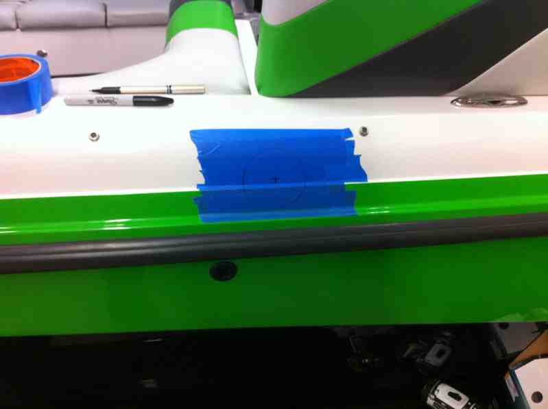

Attachment 17101Attachment 17102Attachment 17103Attachment 17104Attachment 17105
Boy it's hard working up the courage to drill a hole that big in the side of the boat!
Nice work! That's a hell of a mod. You will like that.
Props to you for gittin' her done!
Practice drilling on a piece of wood first!!!!!
Then practice again!
Getting the vent part through takes a little filing.
Only drilled the holes and mounted the neck last night. Doubled up some foam weatherstripping and it formed to the ridges on the side nicely. Looks like it belongs.
I'll plumb it this weekend, hopefully.
This would be a good how-to thread if you are up for it. Pictures and part numbers, step-by-step, etc.
The filler neck I got my dealer to order for $60. The hose's and tee's from a local hydraulic supplier. Attachment 17454Attachment 17455Install was easy. Drill practice holes so you get the spacing right. And have a file on hand for the finishing touches. A little bit of weatherproofing foam to fill the void and your done.
