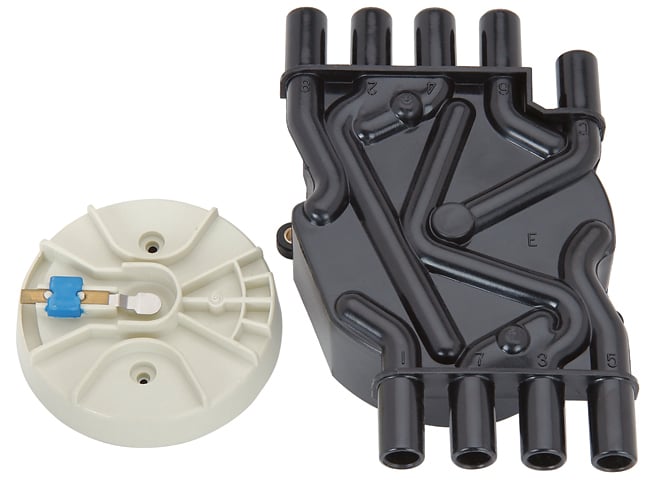

Below is a pic of the motor though
https://ibb.co/VT47Vj5
Yep...that's what I was expecting. It's the flat spider looking one. $34 at my local JEGS Flfor the kit shown.
Attachment 30877
