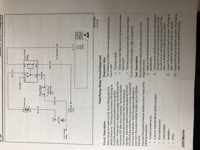

Attachment 29795
Here is a copy of the circuit diagram. It should be the same as your boat. There is a procedure for diagnosing, but it requires a scan tool. Maybe the schematic can help you at least trace down the circuit. Hopefully there's nothing wrong with your ECM. Thats where the initial signal to the fuel pump relay originates.
Huge help.
What I see here is the ECM is the ground for the fuel pump relay (Dark Green/White) - Check continuity to ground while turning key to "RUN" position. This would assure that ECM is triggering.
Check Pink wire from fuel pump relay fuse with ignition in "RUN" - should have +12V - if not check fuse or connection at fuse block
If the relay is clicking - should be able to feel this also - when switched to "RUN" then control circuit is good.
Another way to check is to test 87A (unused) on the fuel pump relay - it should have +12V at all times unless the ECM is telling the fuel pump to run. After 2sec, this should go back to having power, if the circuit is working correctly.
Not sure where "FROM SYSTEM RELAY" is providing power, but this could be the problem if no power anywhere in this circuit, and fuses are all good.

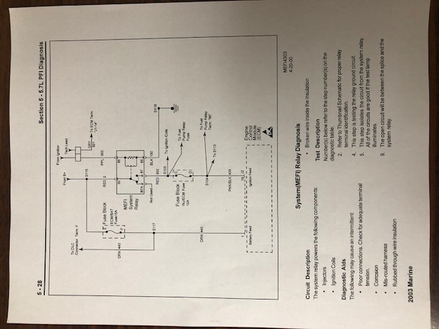

Check out this schematic- MEFI relay circuit. I beleive this is the "FROM SYSTEM RELAY" you mentioned.Attachment 29797
