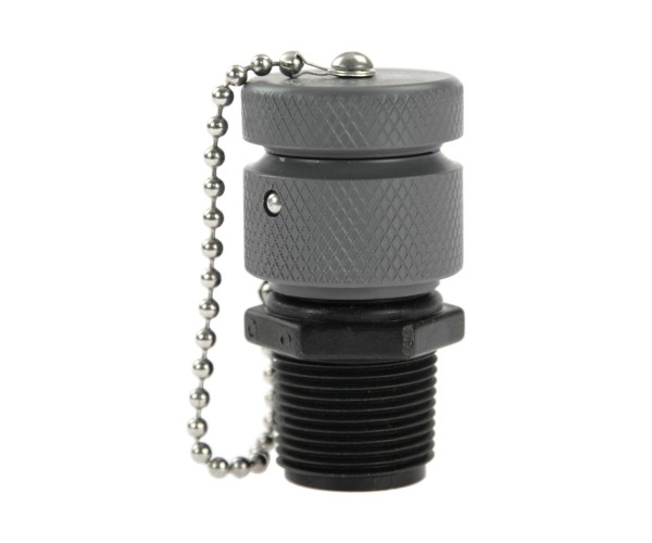

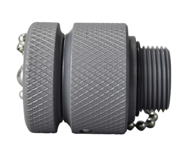

Anyone know if I can plug the pump into my ballast system somehow??
No, the fittings from a FatSac are smaller than the Wakemakers bags on the thread side. Wakemaker does sell a fitting which will fit on the Wakemaker bag and connect to the Tsunami but the fitting right off the fatsac won't screw into the Wakemaker port.
Here's the fitting for the Wakemaker port to the Tsunami pump: https://www.wakemakers.com/launch-pa...onversion.html
Attachment 28873
For reference here's the standard FatSac port to Tsunami pump fitting: https://www.wakemakers.com/fly-high-...ting-w730.html
Attachment 28874
Same top but different threaded bottom
I tried doing that. My staid pumping in but not out. I have the exact fit bags for the craz and I’ve tried all sorts of different threaded fittings but can’t get anything the work with the tsunami pump. I took out a 3/4 vent plug on one of the vent ports on the back of the bag and you would swear they are the same it still couldn’t get the tsunami fitting to work. Being that I only have to use the tsunami to pump out, I can stick it in the plug on the top of the bag and with some patience I can get it almost completely empty. Big pain though. I’m still waiting on parts as well. They were ordered 9 days ago and still not here. I’m in Saskatchewan Canada
