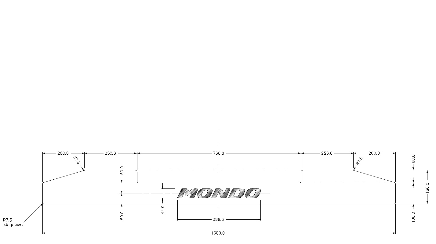

Oh, made a transom protector and trailer stone chip protector (flat angled part forward of the front wheel arch) left and right hand sides. Got sick of trying to polish out board hits in the rear and stones chipping the paint on this trailer part.
Attachment 29572
Attachment 29573
Cheers BruceR, Melb AUS.
Should point out, dimensions are in mm.
Made from 5mm thick grey over black Seadeck, the Moomba is made by removing the top grey part, the part edges are bevelled and are black.
