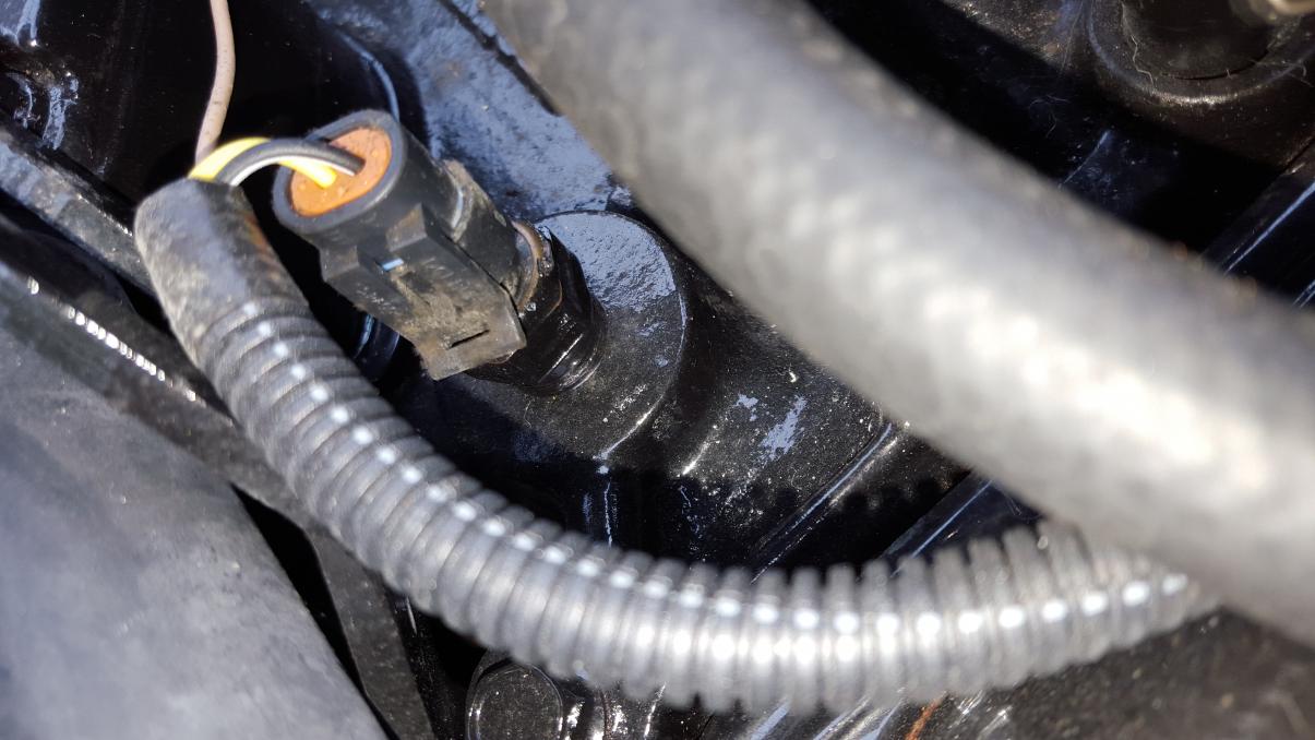

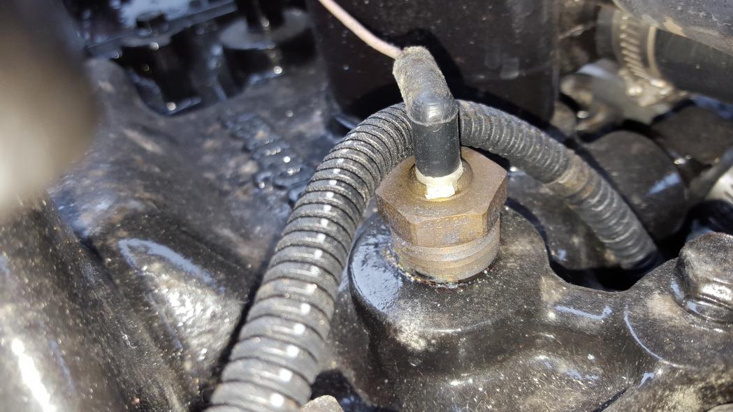

Kind of looks like what I replaced. Attachment 24296 but now I'm hoping it's this one. Attachment 24297
The one on the bottom picture is the one that goes to the ecm I think.
Do those typically go out after over heating? It was working fine until It over heated. I hope it's not the gauge. Seems like a hassle to find and install.
Yes it is for ECM. Is it even a possibility that could fix my problem?
