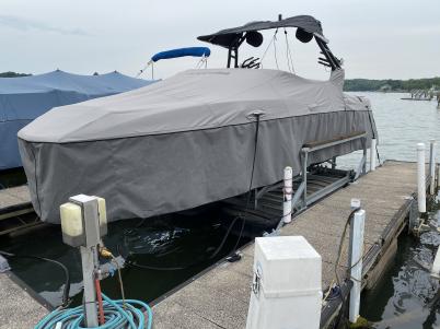

If anyone keeps their Mojo on an uncovered slip, I had my cover modified to add skirts and a transom cover that attaches to the cover. My boat is all black so saves the hull from getting beat up by the sun all day.
