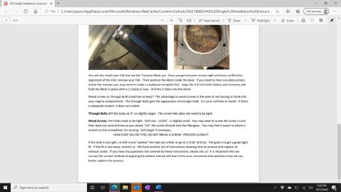

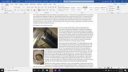

I took a screen shot of the part of the instructions that I thought were different.
I am not sure how to attach a PDF. But i can email them if you would like.
Attachment 29100Attachment 29099
