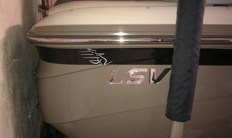

Hey guys, just as kaneboats mentioned, the company is doing their best to rectify the situation. I spoke with Brenda on Friday, and they've acknowledged the issue with the application directions. Apparently these were the first decals of this type and size that they've sent out, and the common instructions don't apply. She said follow the initial directions of cleaning the surface well, then fill a spray bottle with water and one tablespoon of johnson and johnson baby soap. Align the decals (she says alignment tabs are computer generated and spot on, maybe some shifting in shipment or something) Then apply one letter at a time, using a generous amount of the spray solution to both the boat surface and the back of the decals. Then, use a squeegee of sorts to apply decal, working from one side to the other. She said to bend the letter a bit so that not all of the decal is placed against the boat at the same time.
The company is adamant about backing their products, and hopefully with the alternate instructions these things turn our real nice. Personally, I think I'm going to head up to my local vinyl sign shop and see about paying a professional to install the side decals when the time comes.
