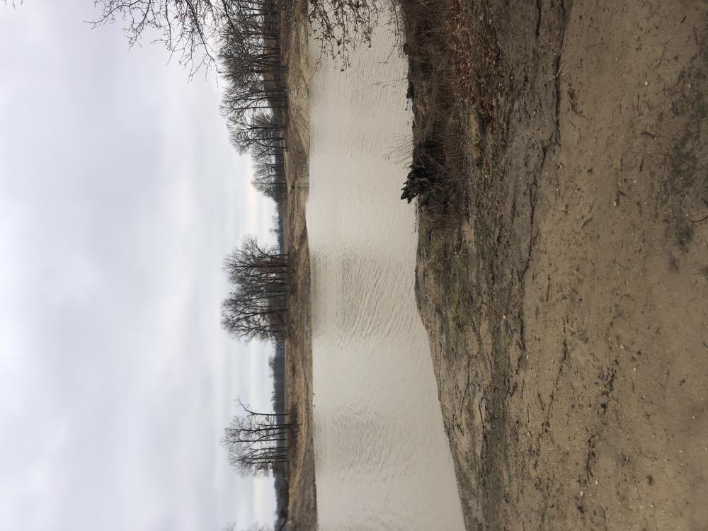

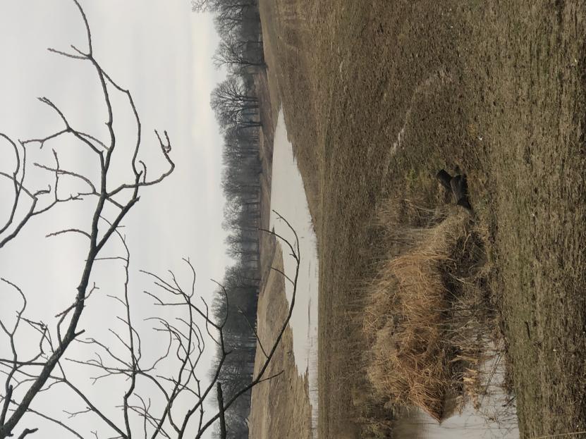

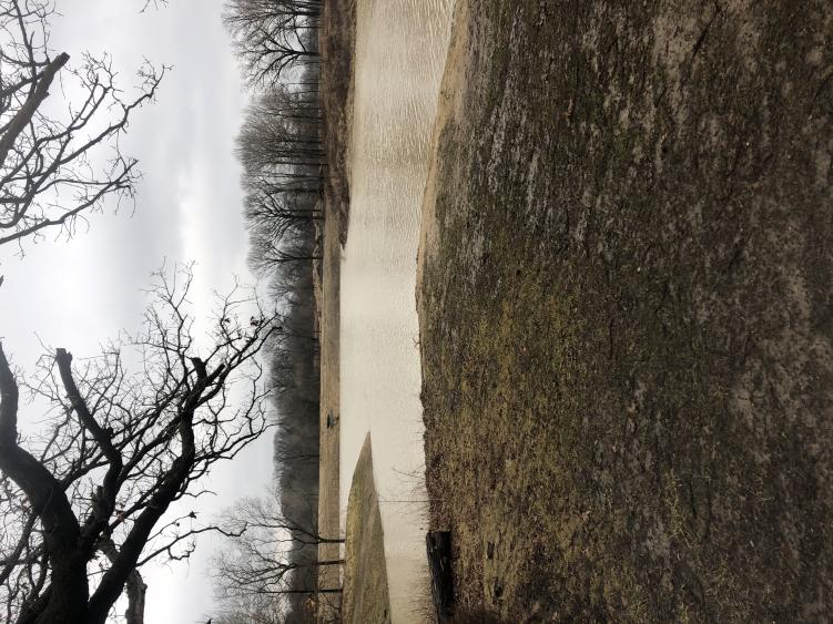

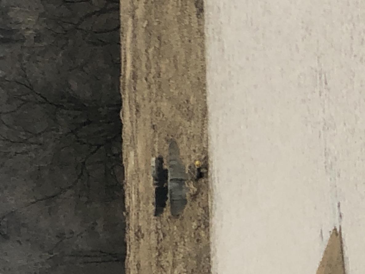

We got about 3" of rain and it raised the lake level 4 to 5 feet. we got about 10 more feet to go. This gives us about 13' at the dam 10' behind the house and 2' at the far north end.
Attachment 29403Attachment 29402Attachment 29404Attachment 29405

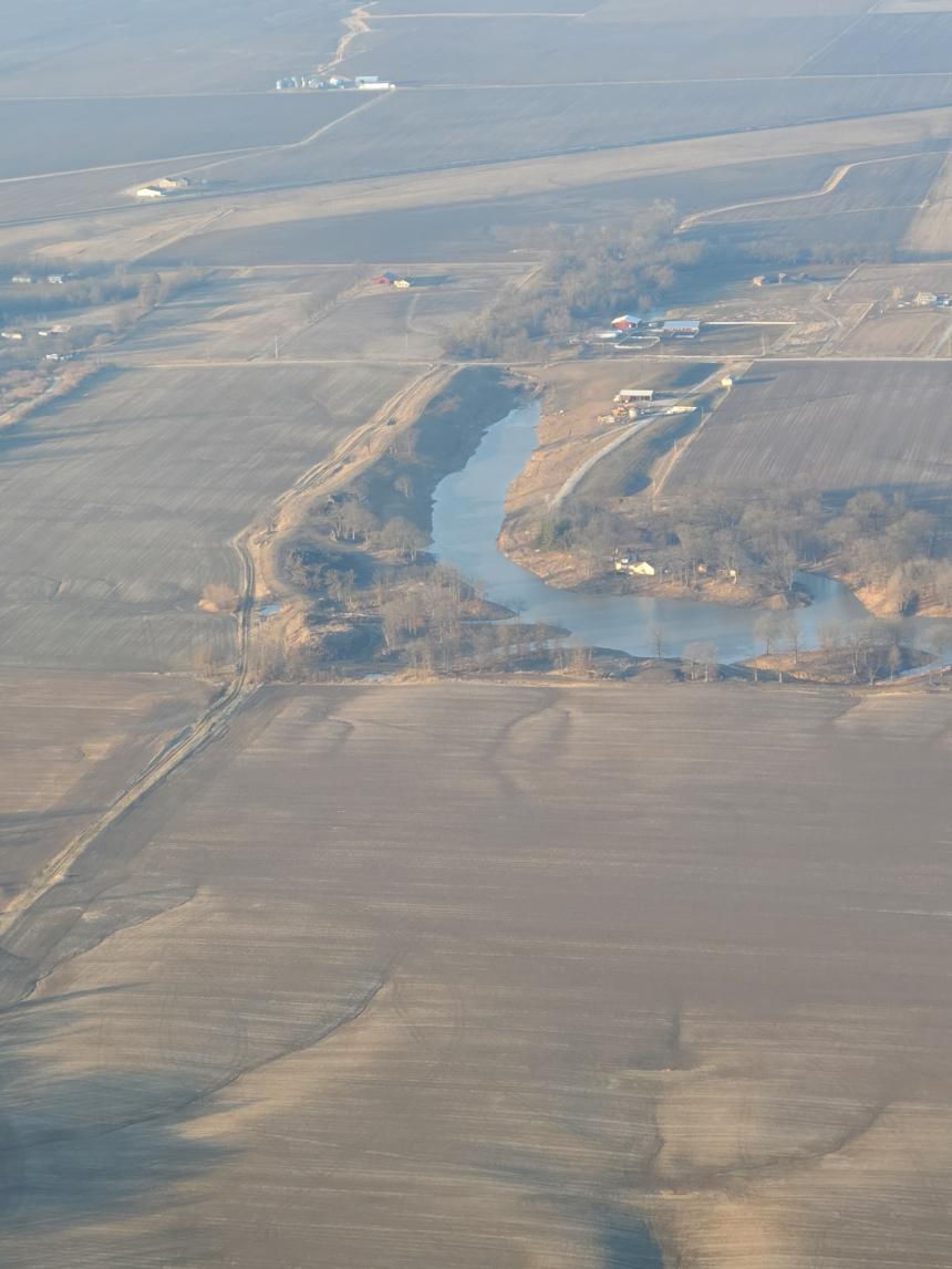

Here is a shot from the air of our lake one of our friends took a few weeks ago.
The picture is missing the dam and one big cove to the north by the dam.
