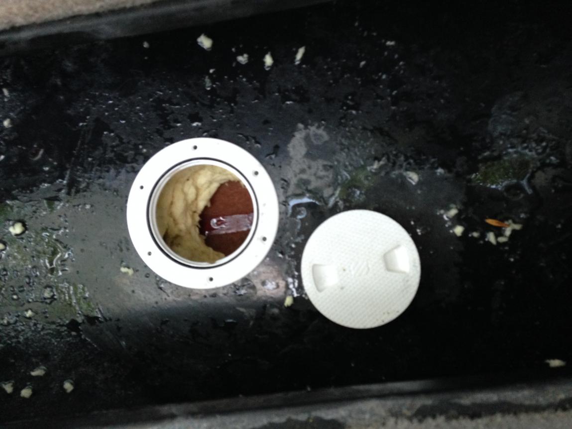

kind of weird, but i've had this 2006 LSV since 2008 and look what I noticed looking forward in the ski locker..
was this hole a concern before even we knew about it? how could the previous owner of noticed it and corrected it?

that's void that created the buzz a few years ago in the manufacturing process on the older models. only fix is to cut a deck plate and suck out water as needed.:mad:
It's hard to say because the photo is hard to get a clear grasp of, but that looks quite similar to how my 08 looks up there. I think that is the factory product...
Which we know doesn't work. I have to suck the water out after every trip, even if I dont take a wave over the bow.

A hole saw is really overkill for this. The cut doesn't need to be perfect; any imperfections are covered by the deck plate (ok only within reason but easily 1/4" of slop)

Foam Removed
http://i.imgur.com/awe3RIWl.jpg
Money Shot
https://www.youtube.com/watch?v=_dNBvsJ1nao
Tools Used
http://i.imgur.com/AzTV9rzl.jpg
borrowed that adjustable drill doohicky from the nieghbour... worked amazing btw if you can't find a 4.5" hole saw
in the end, i got about 5-6L out of the hole.. there will probably be more that settles

Just got to doing my today, got as much water out as I could but I can see it slowly accumulating. I'll come back tomorrow afternoon and see how much is in there. Attachment 22205

I bought a 2015 Outback V back in April of this year. I took my ballast bag out two weeks ago, stepped into the ski locker and go figure, I was standing on a wavy lake while the boat was up on the trailer. I figured I would try to drain it to the back, hooked my tractor to the ball and lifted the front end up until the trailer was nearly on the ground. It was a fruitless labor....... I too think mine is trapped. Sad day. I have contacted my dealer about getting it fixed and they're getting in touch with SC about it. I have to admit, I was shocked to find that this problem was spotted 5-6 years ago, and I'm seeing it in my boat now. Hopefully the warranty covers it, I bought it new, so I don't see why it wouldn't.
I wonder if the dealer would put an access port in for me instead of re-glassing it..... hmm.....
should have been fixed in 2009 , but the access port is a quick and easy mod to extract the water.......
I tore mine apart this winter. The water was never coming from the bow. It actually comes from the bilge. There is a failure between the deck / hull bond creating a passage for water under the bulk head that seperates the ski locker from the bilge. In addition, whom ever installed the ski locker drain installed it at crooked and failed to seal around it. I ended up cutting out all the deck fiberglass and pulling all the foam (which was soaked) from the bilge are, under the bulk head and under the ski locker out. Re-foaming, Re-fiber glassed the hull deck joint, bypassing the bulkhead ski locker drain with a new drain, sealing the entire thing with epoxy and a good 2-3 coats of bilgekote. I left the access hatches I cut initially in the ski locker to make sure water was no longer getting trapped.
Skiiers choice was very helpful in helping me navigate the structure of the boat.. However, it was very obvious once I figured out where the water was coming from that this is 100% a manufacturing and poor design issue. If I had bought my boat new I would have pushed a warranty claim and not backed down. They should be covering this issue under warranty. There is no excuse!
