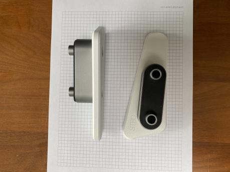

Finally received the surf side pull points. I actually got two sets as there was confusion between the parts department and SC as what constitutes a set. So....
For sale: white surf side tow points, 1 complete set for 2019-2021 Supra towers. $300 with shipping. This is about the cost of the restocking fee I’d have to pay.
Sonic, I took some pics on 5mm graph paper for you to work your machining magic.
Attachment 29232Attachment 29233
I don’t think anything is different, but fitment from the parts catalog only listed 2019-2021.
What is dealer list on that?
$320.00 for the pair. Sonic has the dimensions, so he might be producing some in the near future. The are color matched to you tower based on your HID. They just bolt where the upper board racks bolt on, so I’m sure the dimensions are the same on the 2018 bolt holes.
