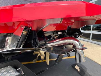

I am sure it’s an EZ Drive system, however the throttle integration might be SC proprietary.
This system looks better than bu or Nautique as it’s two units outboard of the exhaust so the thruster don’t get cavitated with exhaust air.
https://uploads.tapatalk-cdn.com/202...14dfcb36d6.jpg
It has a dock hold feature and yes, it’s supposed to be useful picking up your down rider.
