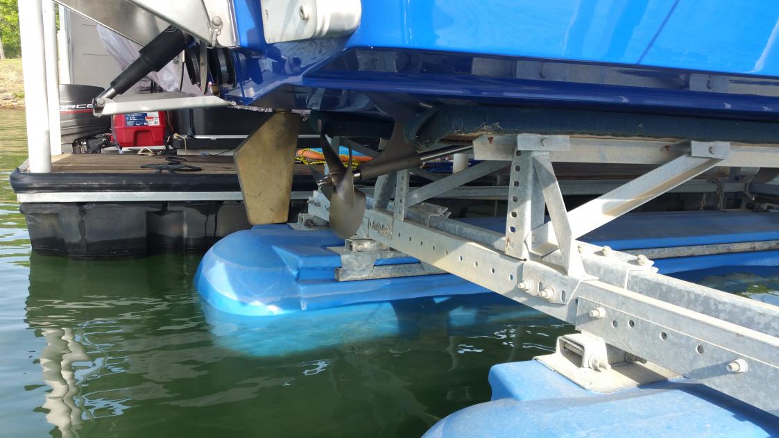

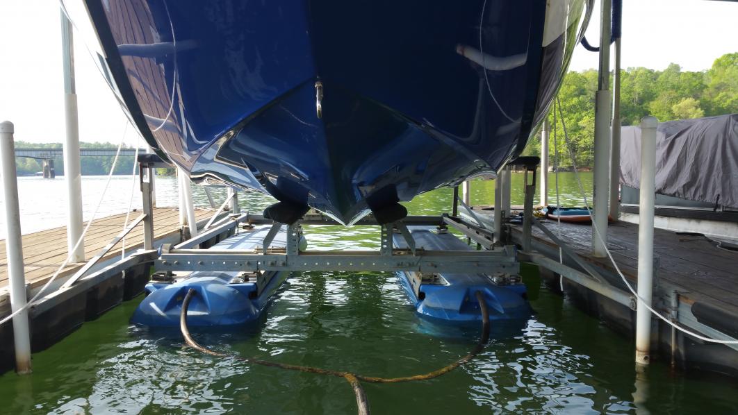

Here's my experience from my 6000SW lift, and one learning tip. Hydrohoist wants you to not have the prop spinning as you enter the slip. They want you to glide in and make any adjustments with your many pairs of hands. I'm on open water where it gets rough, 3ft rollers coming in as I'm coming into the slip, so my first experience to my side entry slip in rough water means I'm in gear to steer and pop it in reverse to keep me crashing up front. Well one Sat afternoon, I clipped the bunk with the prop. No damage to the prop but frustrating nevertheless. They don't recommend trimming the bunk as I wanted to do should it happen. As you glide in you should have 2 guide ropes [don't have to be thick] setup in front that you run to the back cleats to center the boat while you flip the switch to raise the lift. As the boat gets lifted slack will come into the line, they recommend you keep the guide wires attached in case the lift fails. Congrats on the lake house, unfortunately it will involve more work and is less the retreat feeling when you are the one pressure washing the dock and maintaining everything. All that said, wouldn't trade it for the world.
