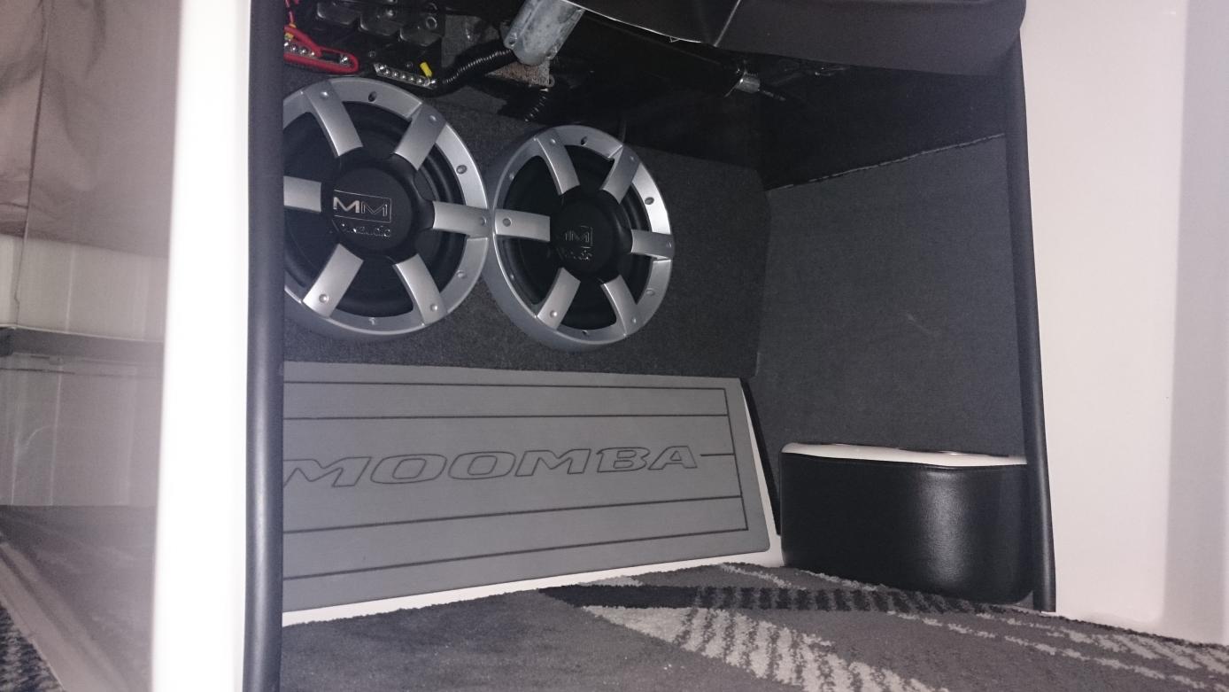

Got a couple of Polk MM1040's subs in under the helm on our Mondo 2014 to match the 6.5" in cabin Polk MM651UM's.
Attachment 25284
Attachment 25285
Been using them a bit this Summer, puts a smile on my face every time......
