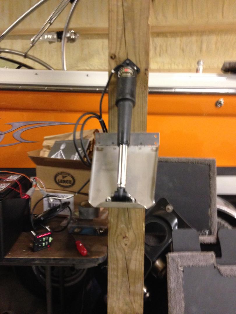

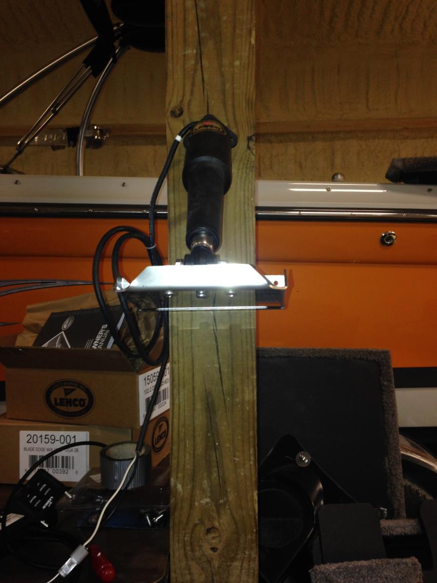

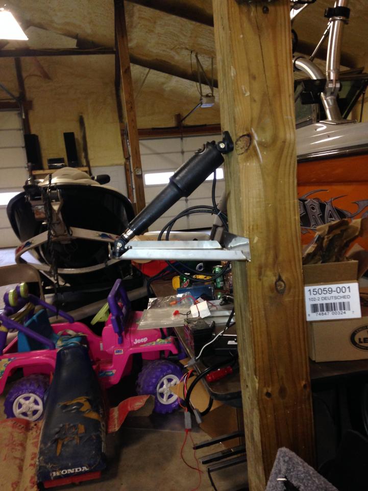

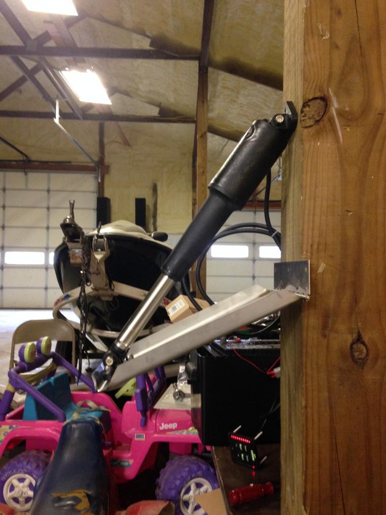

Install the two trim tabs Like they are designed for but use a longer stroke actuator to use them as Surf tabs.
I was looking at a kit with the standard 2-1/4" stroke actuators but the plates will only go down to about 22 degrees.
with the 4-1/4 stroke actuators it will go down to about 60 degrees. this was verified with cardboard and a tape measure this weekend.
I think I will be good on the controller it has an input on it. So if it does not have 12 volts on it, it automatic raises the plates to the all up position. (I was going to put this in a rocker switch to turn the system off and on with.) It also has led indicators to tell you were the tab is.
This weekend I winterized my boat and a cut out a piece of cardboard for the tabs.
Here is what I came up with.
