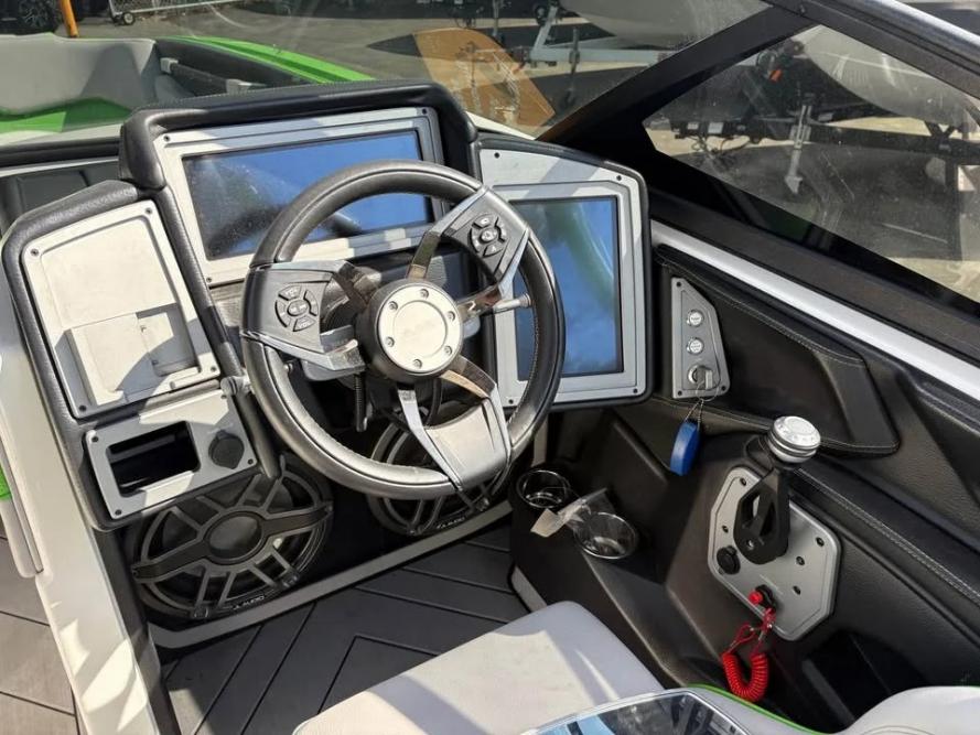

For subwoofers, has anyone done a similar installation to the picture in the link below with 2x 12 inch JL M7-12IBs in free air? Would love to see more pics of a similar installation with trying to seal off the front to the back.
I don't think I have permission to post photos so here is the link:
https://olympicmarineandrecchilliwac.../#lg=1&slide=6
Attachment 31123
Yes, they lost some foot space under the helm but I'll gladly take that for more bass/impact. I'm pretty sure I heard this same boat on Osoyoos lake in BC and it pounded pretty good. Problem is that I would really like to use a JL 12 with the lights to keep the whole interior consistent with the lighting. Sealed would require like 3ft^3 and ported like 5ft^2... any info would be much appreciated.
