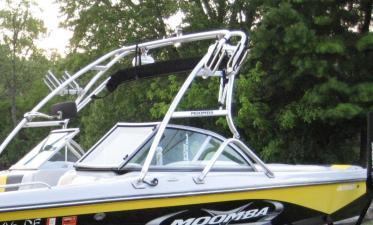

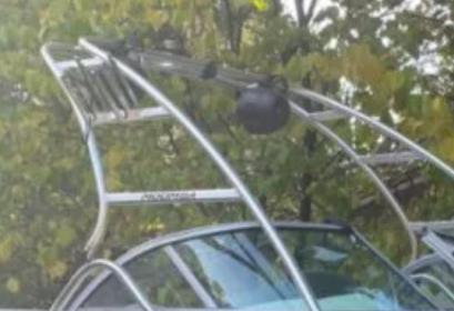

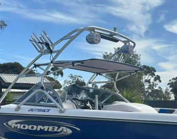

My question is around the towers. What position is best to mount the towers? I have the red-a-cage tower. There are three locations that I have come across:
1. On the flat supports between the 2 tube sections of the tower:
Attachment 31110
2. On the tube closest to the stern, with exposed wiring that goes into the tube closest to the bow.
Attachment 31112
3. On the tube closest to the bow
Attachment 31109
I know that I need to run the wires down the tower closest to the bow. Am wondering for those who have the experience and have done the install or have this type of tower, what works best?
If I mount to the supports between the tubes, can I run the wires inside the support? Is there a "hole" that goes into the downtube that I need? Same question when mounting on the tube closest to the stern.
