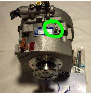

Anyone experience red oil in bilge? 2019 Craz about 250 hours was out on a hot weekend with a full crew and full ballast running the boat for a family hard 4-5 hours. Next weekend noticed the bilge pumping out reddish water. Checked the bilge and sure enough about an inch of water (which is typical for my boat) in the bilge but a milky reddish colour. Boat is running fine for now but I’m assuming there is a leak somewhere. My questions now are what is the best way to clean the oily bilge? Could running the boat hard on a hot day (35 Celsius) with a full boat somehow increase the pressure in the transmission and cause the leak and it will fix itself? Any typical places anyone found a transmission oil leak? Any thoughts on the fluid coming from the V-drive or transmission? Could I run the boat (slowly) back to the boat launch if the fluid levels are OK? Thanks all.

Holdmybeer you were right on the money oil ATF coming out of the vent, changed the ATF and now good to go, was also a small leak in the oil filter when I had the oil changed I believe the filter got tightened a little to much and pushed the oil ring on the filter out of place.
