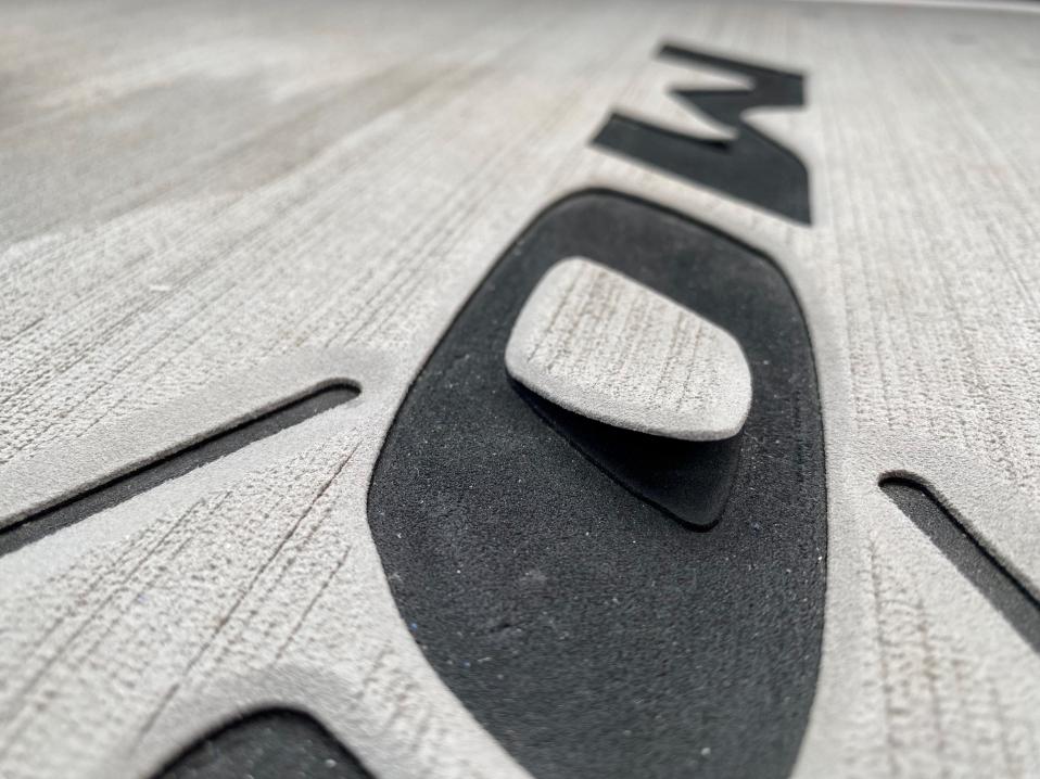

I noticed that some small pieces of our 2021 Mojo flooring are coming loose. What is the best way to reattach? You can see the middle of the "O" and a corner of the "M" on the photo. TIA
Attachment 30895
Attachment 30895
Get it replaced under warranty
Some waterproof gorilla crazy glue or contact cement should work easily on that. But I would keep an eye out for any other areas. Could be a bad batch of material.
what is the warranty time for the flooring?
thanks.
if it's warranty, dealer repair off-season. if it's not, epoxy and call it a day.
sometimes I hated to bother the dealer with small stuff that, frankly, could be made decent with some 2part epoxy but if it gets worse I'd hate to be in the "you fixed it so it's not warranty anymore" camp.
Super glue.
Starbond or similar.
IMO not worth dicking with a warranty claim, they are more likely to screw something else up in the process.
2 minute fix with 5 dollars of super glue.
3M adhesive spray works great.
If you are getting bubbles, I went to Home Depot and bought a syringe used for marinades. I filled it with Gorilla glue and injected it into the bubble then put a weight on it. Seems to have worked pretty well
