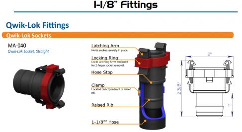

Anyway, instead of ordering their kit, it seems cheaper to order 8 fittings and two bags. Worst case it's $420 (bags) and $40 (fittings). The kit is $560. I asked the online sales rep which fittings I needed and he said he couldn't share that information with me and that I should buy the kit. WTF?
Best I can tell, each bag has four (4) ports. For my Mondo, I have a supply and an overflow hose for each side. Both hoses use the Flow-Rite fittings. Looks to me like these Wakemaker male fittings would do the job.
https://www.wakemakers.com/wakemaker...g-fitting.html

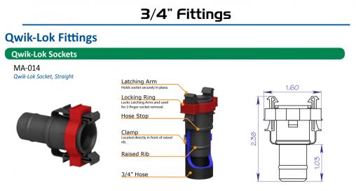

Unless, the factory Flow-Rite fittings are 3/4", in which case I need these:
https://www.wakemakers.com/dry-lok-1...g-fitting.html
I measured the factory male port. The ID hole of the fitting is 3/4" but not sure how these are measured.
Anyone know which fitting I need?
